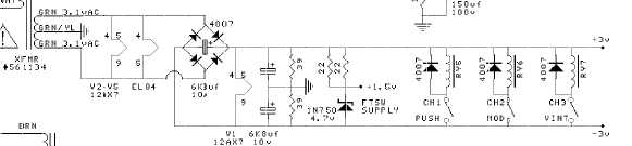

What is the voltage leaving the rectifier?
What is the voltage at the two 22 ohm resistors?
What is the effect of the 4.7 volt zener diode?

It is hard to tell the exact number due too many unknowns. But the the peak voltage will be around 3.1V * 1.41 - 0.7V = 3.6V But we have a bleeder resistors, so the voltage will be probably around 3V as noted in the diagram (with respect to ground ).
6V ( the voltage seen across 22 ohm's resistor and a Zener diode) minus the Zener diode voltage (6V - 4.7V) = 1.3V
Zener Diode together with 22 ohm's resistors forms a Zener shunt voltage regulator. The output voltage will be Vz ≈ 4.7V with respect to negative rail. But because ground is up by 3V from negative rail. The Vout with respect to ground is around 4.7V - 3V = 1.7V
I believe the output from the regulator will be...
+/- ((6.2 * √2) - 2Vd)/2
Vd can be around 1V for a power diode but I haven't checked that one.
This would make the output around +/- 3.3v. The diagram says +/- 3.1v on the right hand side.
The 22R and 4.7v zener diode work together to make a 4.7v output measured with respect to the -3.1v rail. 4.7-3.1=1.6v. The drawing says 1.5v which is close enough.
The exact voltages will vary as this is an unregulated power supply.
In case it's not obvious +/- above refers to the two voltage rails eg +3.1v and -3.1v.

Also, I assume the AC voltage is 180 out of phase on the two 3.1 VAC taps.
Is this correct?
Mr Watters..give me a bit to read what you said...I am sure I will have some questions!..lol
With respect to centrer tap the answer is yes.

There's a couple common labeling scheme for transformers
6.2VCT = a 6.2 volt winding with a center tap
3.1-0-3.1 VAC = same thing
observe the latter is less ambiguous about which wire is the reference point for voltage, ie where the meter's black lead goes.
Remember my soapbox - voltage is potential difference ie between two points.
Are those two points the + and - wires leaving the rectifier , in which case it's one voltage the numerator of Cwatters' expression,
((6.2 * √2) - 2Vd) = 6.77V rail to rail (for Vd=1)
or are those two points each wire and circuit common in which case it's two voltages , each half that (as he stated) , ~3.3V rail to common?
When a reference point for a voltage measurement is not given we often assume it's circuit common.

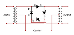

Is there any case where a 4 diode bridge rectifier would not have AC on all 4 diodes??
Other people have worked on this amp or that is to say they have messed up so much stuff I not sure I will ever get it fixed. I ask the question about the rectifier because one diode's cathode is not connected to the AC trace.
I ASSUME it has to be but based on the crazy design of the switching matrix and other strange stuff it may need to be connected to the bumper of my truck..lol
Perhaps I need to take a break...lol
The cathodes of the two right hand diodes should have around +3V DC on them.
The anodes of the two left hand diodes should have around -3V DC on them.
To finish CWatters' thought
and their other ends ought to have 3.1 VAC with respect to circuit common.
Use your o'scope.
Hmmmm ... you asked Is there any case?
Ever ?
there exists something called a "ring modulator"
which resembles a bridge except all the diodes point in same direction.
https://en.wikipedia.org/wiki/Ring_modulation

Planobilly - If the power supply isn't working can I suggest you measure the voltage on various nodes (all with respect to earth) and mark them up on your circuit diagram. Post that here and we might be able to help find the fault.
If it's pretty old many of the Electrolytic Capacitors might have failed or be on the way out. Do any show signs of physical distortion on top like this..
http://electronics-diy.com/schematics/1260/repairing-switching-power-supply-3.jpg
There were to positions the diodes in question could fit in the PCB. It was an easy mistake for someone to make. I replaced the diode and have the voltages you indicated in your post. -3.28 and +3.28 I now think all power supply issues are resolved.
As there are traces on both sides of the PCB and one is required to remove 20 pots from the chassis to get to the bottom side of the PCB, it is not very easy to work on this amp. Small holes filled with solder connect the traces from the bottom to the top of the board and exist in places under things like caps and resistors where one can not see them.

Hi Cwalters,
To bring you up to date I have replaced every electrolytic in the amp. I replaced all relays also. I also replaced both op-amps and the LM3914 IC. New reverb tank and all new known good tubes. I have replaced some of the pots but have better ones on order which I will change when they arrive.
The channel switching is now working with both the rotary and foot switch but something is messed up with channel two.
When switched to channel two no sound is produced unless the channel 3 master is turned up a small amount. Also the tone stack on channel two is not working. Also the reverb is not working on any channel.
My investigations have indicated that the signal path works like the Block Diagram shows based on the fact that the grid of V2a and V2b have no signal when the amp is switched to channel 2 or 3.
What I really need help with is a troubleshooting method to deal with the transistors and the relationship of the switching matrix and what is called Q1-Q3 and Q4. Even if we find the faults it will be some time before the transistors I have ordered get here. I am really confused as to the exact signal path for each channel and what must be working correctly as every stage seems to be connected in some way. This is the most complex guitar amp I have ever tried to work on.
Thanks,
Billy
EDIT: Testing this morning indicates that although the channel 2 LED comes on when switching to channel 2 the signal is going through channel 3 as all the channel 3 volume and tone controls operate and only the channel 2 volume control (gain) has any effect. So something is not switching correctly.
SECOND EDIT: This is really baffling! I plugged the guitar in again and all channels seem to be working, well at least all controls on each channel function in a more or less normal way.
I have to go to Miami...be back later today
Made some progress. Someone had installed PNP transistors where there should be p-channel junction FETs. When I repaired that issue the solo control started working correctly. Now I am in the process of looking to see if the op-amps are installed correctly because I put the new ones in the way they were installed when I got the amp. The good news is I installed pin sockets and have plenty of op-amps.
The takeaway is don't assume anything.
Cheers,
Billy
More progress...got the reverb working. There was a broken trace under a pin scocket. I had to de-solder several resistors to trace it. Not an easy fault to find.
