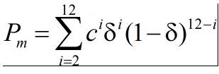

1. Homework Statement
if δ=7.7 %; Pm=0.2349 and
if δ=30.8 %; Pm=0.9180.
2. Homework Equations
Equation P_m = sum from i = 2 to 12 of c^i times delta^i times (1 - delta)^(12 - i).
We can calculate value of c if we know value of Pm and δ? Please help me.
Thanks You![/B]

If your formula is really correct as written, then for given ##P_m## and ##\delta## you just have a 12th-degree polynomial in the parameter ##c##, so you can find the value of ##c## using a numerical polynomial root-solver.
Sure, you have an equation of form: ##y = \sum_{i=2}^{12}a_ix^i## and you want to solve for ##x## given ##\{a_i\}## and ##y##.
I'd use Newton-Raphson since I have a computer right in front of me.

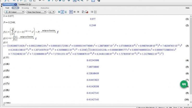

Really Thank you very much.
Finally i got. But need to long time insert. Look my solving in Maple
Screenshot of a Maple worksheet showing numeric calculations: b = 0.077, P = 0.2349, a defined function f(x) and iterated values of g(x), with results listed for g(10), g(4) through g(9) and g(10) converging to about 6.411427143.
If you have any idea, please advice me and help me. Thanks you all.
It looks like you have figured out how to use Newton's method with Maple. Good job. Of course, if you are going to use Maple in the first place, you don't have to program Newton's method, you can just let Maple solve it for you in two steps like this:
> restart;
> f := (delta, P) -> sum(delta^i*(1-delta)^(12-i)*x^i, i = 2 .. 12) - P;
> fsolve(f(.077, .2349));
and you can put any other pair of numbers in that last step.
