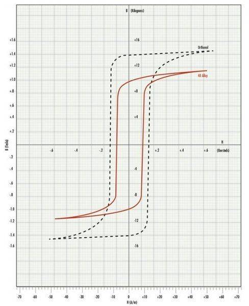

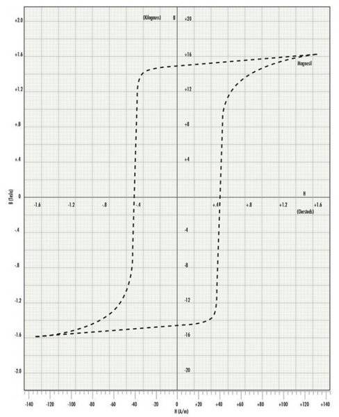

no, they were a guess at what steel you might be usungm4 crgo hmmm
http://www.kryfs.com/knowledge-center/technical-papers/pdfs/article1.pdf
looks like you're about up to the knee
you should see some distortion from sine in the magnetizing current wave
from http://www.vikarsh.com/toroidal-cores.html
Comparative Chart
Toroidal core & C.T manufacturers need to know the B-H values of CRGO Materials after annealing over a wide range of Flux densities ranging from 100 Gauss to 19000 Gauss. We give below the actual values obtained on a core of size 150 mm OD x 100 mm ID x 25 mm HT with a stacking factor of 95% and a frequency of 50Hz.
....Tesla...M4..at/cm...23MOHgrade at/cm.. two other specialty cores...

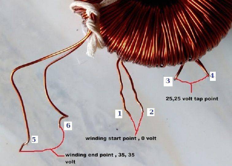

  • #42
Hello hardy sir
I am completed all secondary winding
As follows 35 25 0 25 35 .When I measure 35 volt winding respective 0 it showing both 35 volt is OK but when I measure 25 volt winding respective to 0 volt one 25 volt tap shows 10 volt why this happening it shows 25 0 10. attach photo of completed transformer https://drive.google.com/file/d/0B5ROBprWe44vNDIyUlFoVmctLUk/view?usp=sharing
  • #43

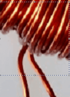

hmmm i can't quite tell how you wound it
looks like you wound two wires ?
Here's your "start point"
do both wires go up over top and continue wrapping
or does left one go underneath ?
Next, verify
do you have two completely separate windings?
Place labels on your wires like this and find with ohmmeter which three are with each winding.
AND
that the two windings are indeed separate.
Then re-arrange your labels so that one winding has odd numbers 1(start), 3(25 tap), 5(35 finish)
and other winding has even 2(start), 4(25 tap), 6(35 finish) .
Verify again that even labels are on one winding and odd on other
Now energize your transformer and measure the voltages
1-5 (expected = 35V) measured = ? ____
1-3 (expected = 25V) measured = ? ___
3-5 (expected = 10V) measured = ? ___
2-6 (expected = 35V) measured = ? ____
2-4 (expected = 25V) measured = ? ____
4-6 (expected = 10V) measured = ? ____
Next, connect your two start wires 1 and 2 together
measure voltage 3 to 4 , I expect zero, what do you measure ? ____
measure voltage 5 to 6, I expect zero, what do you measure ? ____
If you get those readings try this
disconnect 1 from 2
connect 1 to 6 and use that for 0volt
voltage 1&6 to 5 ? (expected 35) __
voltage 1&6 to 2 ? (expected 35) __
voltage 1&6 to 3 ? (expected 25) __
voltage 1&6 to 4 ? (expected 10) __
voltage 5 to 2 ?... (expected 70) __
Might be we'll have to unwrap some turns and relocate one of the 25 volt taps...

All your suggestion is correct.And all result as you expected.
I am using only one tap at a time means 35-0-35 or 25-0-25 .so I don't have to unwrap turn.

Okay, there's our trouble
i didn't think about having to place the 25 volt tap 10 volts away from opposite ends of the two windings if they're wrapped same direction
That's one morelittle detail to be aware of, we will both do a better job of helping the next guy on that point...
If you want to you could add more turns to that 10 volt tap to get 25 volts, it'd work, just a minor "ugly" add-on.
On the positive side
you successfully wound that transformer without creating any shorted turns
and it behaves exactly as it should for how it was wound.
I call that a SUCCESS !
If you want to start a few more turns at your 10 volt tap and bring out a new 25 , you'll have a transformer that is functionally just what you wanted.
And - look how much we learned !
Congratulations on a nice job.

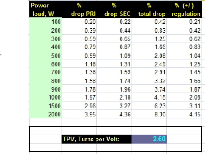

Which isn't surprising, the core has a window 1.5X bigger than your 418 VA core, and 418 X 1.52. = 940,
since it's also got 25% more cross section multiply by 1.25, 940 X 1.25 = 1175 .
Try your spreadsheet ? It seemed to work okay.

From your spreadshseet
great regulation,,
2.6 turns per volt = 0.385 volts/turn
0.385 / 100π = 1.22 milliwebers , in core area of 12.5 square cm
1.22 X10-3 W / 12.5 X 10-4m2 = 0.979 Tesla, should be safe for most transformer cores i'd think , it's 1.39T peak
Sanity check looks okay
losses at full load show around 35 watts primary , 75 secondary ,,, so at 2kva it'll run warm..
But i think it'll be a better transformer than you could buy . And you'll have fun.
