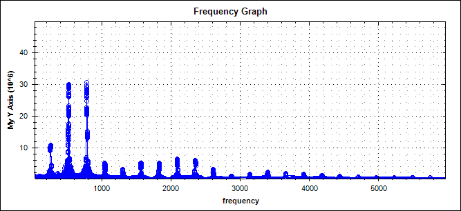

ok I did this :
buffer[n] = ((Amplitude * Math.Sin(Math.PI * Frequency * n1 / 44100D)) + ((Amplitude / 2) * Math.Sin(Math.PI * (Frequency* 3) * n1 / 44100D)) + ((Amplitude / 2) * Math.Sin(Math.PI * (Frequency * 2) * n1 / 44100D)))
when I play it there is no beats, but the sound still sound boring .
Also I did an FFT and I set Frequency to 261.60
I got thisI got 263.7817 is the 1st peek
522.18 is the second peek
785.96 is the third peek.
ok why are 522.18 Hz and 785.96 Hz higher than 263.78?

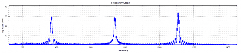

I set Frequency to 370 Hz
I got this:
Frequency graph titled Frequency Graph, plotting My Y Axis (10^-6) against frequency from about 100 to 1400. Three sharp peaks appear near 370, 740 and 1110, the rightmost reaching the highest value near 33.
I got 371 Hz is the 1st peek
737.51 Hz is the second peek
1108.9599 Hz is the third peek.
so this time 1108.95 is the highest point
why?
and why not 371Hz?
I do (Amplitude * Math.Sin(Math.PI * Frequency * n1 / 44100D))
the other two have Amplitude/2
oh I set Amplitude to 1

You have forgotten the 2 in Sin( 2 * Pi * frequency * n / 44100 )
The spectrum you show at the top of post #7 is a Dirac comb function. It is it's own Fourier transform.
It is the spectrum of a sawtooth or a repeated narrow pulse with a repetition rate of 370 Hz.

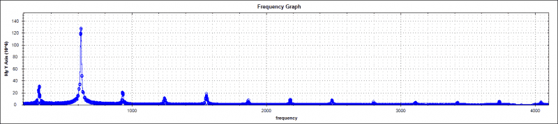

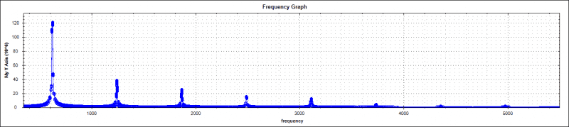

ok I went back down to this :
buffer[n] = (float)((Amplitude * Math.Sin(Math.PI * Frequency * n1 / 44100D)) + ((Amplitude / 2) * Math.Sin(Math.PI * (Frequency * 3) * n1 / 44100D)) + ((Amplitude / 2) * Math.Sin(Math.PI * (Frequency * 2) * n1 / 44100D)));
Frequency = 622.3 Hz
Amplitude = 0.6
This is what I have :
Time-domain plot titled My Test Graph, blue waveform with irregular periodic peaks and flat troughs at about -33, Y axis from -40 to 40, X axis Time (10^-3) from 343.653 to 344.049.
and this is the FFT:
Frequency graph of a signal's spectrum with x-axis frequency from 0 to about 5000 and y-axis labelled My Y Axis (10^-6), showing a tall peak near 620 Hz and smaller peaks near 1250, 1870, 2500, 3100 Hz and beyond.
peak 1) 624.46 Hz
peak 2) 1243.45 Hz
peak 3) 1868.005 Hz
Ok that one works because the Frequency = 622.3 Hz, however I did think that 1243.45 Hz and 1868.005 Hz would have the same peak

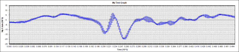

I set Frequency = 87.31 Hz and Amplitude = 3
and I got this :
Line graph titled My Test Graph of My Y Axis (10^-3) against Time (10^-3), with a dense blue waveform that is irregular rather than a clean sine wave, with a sharp dip near 0.21 and a tall spike near 0.23.
and this is the fft:
Frequency graph of a signal's FFT spectrum, frequency on the horizontal axis from 0 to about 1800 and My Y Axis (10^-4) on the vertical axis, showing a dominant peak near 260 with a sequence of smaller evenly spaced peaks.
yeah that is so wrong :
peak one ) 172.26 Hz
peak two) 263.7817 Hz the sec peak it really high
Peak 3) 436.04 Hz

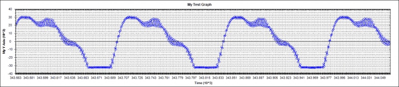

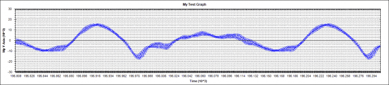

ok I set Frequency = 311.1Hz and Amplitude = 1 and I got this :
Line graph titled My Test Graph of My Y Axis (10^-3) against Time (10^-3), showing a distorted, clipped sine-like waveform with flat plateaus near 30 and -30 and irregular dense oscillations in the middle sections.
and the FFT:
Frequency graph of My Y Axis (10^-6) against frequency from 0 to about 4100, showing a tall spike near 620 Hz at about 127, a smaller peak near 310 Hz at about 30, and smaller peaks at multiples above.
Peek 1)312.231 Hz
Peek 2)624.462 Hz
Peek 3)931.3110 Hz
ok, why is Peek 2 a lot bigger than peek 1 ? Peek 1 is the fundamental frequency, not peek 2
The flat tops and bottoms of your synthesised waveforms are clipping due to something in the code.
Clipping generates harmonics. You need to reduce the amplitude to make the signal linear.

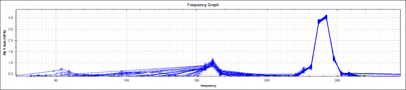

ok i did Frequency = 80 Hz and Amplitude = 0.25 and I got this :
Line graph titled My Test Graph, with time in units of 10^3 on the x-axis and My Y Axis on the y-axis, showing a noisy wavy signal that dips to about -1000 near the middle and rises to about +1000 at the right.
and this for the fft:
Frequency graph of an FFT spectrum, frequency on the x-axis from about 25 to 280, My Y Axis (10^-6) on the y-axis from 0.5 to 3. Tall peak near 240 reaching about 3, smaller peaks near 53, 160 and 228, and a flat baseline elsewhere.
Peek 1)53.833Hz
Peek 2)161.4990 Hz
Peek 3)242.2485 Hz
it got peek 2 and 3 right but one is wrong and one it should be 80Hz and that is the one that should be the biggest right ?

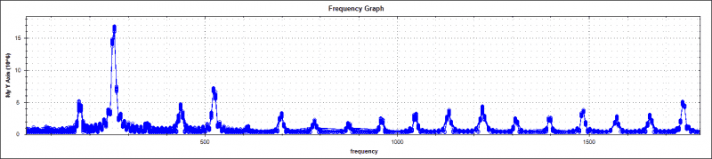

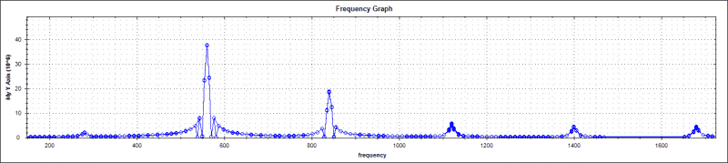

ok i did Frequency = 280 Hz and Amplitude = 0.25 and I got this :
Line graph titled My Test Graph of a periodic waveform: My Y Axis (10^-3) from -30 to 30 against Time (10^-3) from about 196.808 to 196.296, with a repeating pattern of peaks near 15 and troughs near -16.
the FFT:
Frequency graph of My Y Axis (10^-6) against frequency from about 150 to 1900, showing sharp peaks near 280, 560, 840, 1120, 1400 and 1680 with the tallest near 560 at about 38.
Peek 1)279.93Hz
Peek 2)559.863 Hz
Peek 3)839.794Hz
ok why is Peek one so low and peek 2 so high ?
in my equation Frequency is the only one that Amplitude is not dived my 2
Frequency * 2
Frequency *3
both have Amplitude/2
so is Frequency *2 really the fundamental frequency? if so why?
I really thought it Frequency because it has the highest Amplitude out the 3.

you might be overdriving the microphone or its input on the sound card resulting in clipping ?
