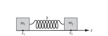

Two masses 𝑚1 = 100g and 𝑚2 = 200g slide freely in a horizontal frictionless track and are
connected by a spring whose force constant is 𝑘 = 0.5 N/m. Find the frequency of the
oscillatory motion of the system. [Hint: write down the equation of motion of each mass in
the center of mass frame]
m2(x2) = -kΔ(x2)
m1(x1)=-kΔ(x1)
Here is the diagram of the problem:

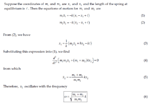

and here is the answer of the question:
What I don't understand is equation 1 and 2.
The Hook's law states that F = -k(change in x)
Why the change in x1 equals to x1-x2+l? x1-x2 equals to the length of the compressed spring. I cannot convince myself that the length of the compressed spring plus the length of the uncompressed spring equals to the change in x1.
Doesn't look like that !
Only if someone tells us what ##x## is !
x1 and x2 are the positions of the 2 masses as a function of time. These are changing all the time. That isn’t the length of the compressed spring (or the uncompressed spring) that is the length of the spring at any moment. (The whole solution takes the masses as having no width, but that is fine as any width just gets incorporated into l and you can call l the positions when the spring is at equilibrium rather than the length of the spring at equilibrium)
The length of the spring at any moment x1-x2 (or with just a change of sign x2-x1) minus the equilibrium length l is how far the spring is stretched or compressed at any moment. This is the x that goes into Hooke’s law. Equations 1 and 2 are simply Hooke’s law with the appropriate sign change for which direction each mass is being pulled.

Tony Hau said:
I am confused, can you explain more?
Apparently. Your "change in x" in "F = -k(change in x) " requires definition. Something like "length minus length in the state with F = 0".
In the picture ##x_2 > x_1## clearly. So ##x_1-x_2 < 0## and the spring is relaxed (F=0) when ##x_1-x_2 + {\mathcal l} = 0## .
With ##x_1-x_2 + {\mathcal l} < 0##, for example when ##x_1## stays the same and ##x_2## is increased, the spring will pull to the right on ##m_1##, i.e. ##\ddot x_1>0##.
Conclusion: ##m_1\ddot x = -k(x_1-x_2 + {\mathcal l} )## is the correct expression for ##m_1##.
@Tony Hau: Can you now do the same reasoning for to get an expression for ##m_2## ?
Note: there is a typo in (2) -- and (3) is correct -- I now understand your confusion.

Is it ##m_2\ddot x = -k(x_2-x_1 - {\mathcal l} )## for the equation 3?
It is because when x2 -x1-l<0, the spring is compressed and the acceleration of mass 2 is positive,directed towards the right.
One last question: I am confused with equation 5. What does that x2 on the right hand side mean? x2 is not the difference between the unstretched and stretched spring in this equation. It is simply the coordinate of x2. In that case, x2 is always positive as shown in the diagram. That means that the acceleration of x2 is always negative, directed towards the left. It doesn't make sense.
Equation 5 is obtained from equation 4 by two integrations. Each should introduce an unknown constant to be resolved using boundary conditions. The author seems to have forgotten this in the second integration.
Have a go at doing it correctly.
Tony Hau said:
Is it ##m_2\ddot x = -k(x_2-x_1 - \ell )## for the equation 3?
Actually that's the corrected version of Eq. (2).

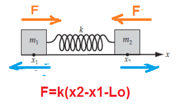

The masses are connected to the ends of the same spring, so they ave subjected to forces of the same magnitude and opposite direction. x1 is the position of m1 and x2 is that of m2. The length of the spring os x2-x1, and the magnitude of the spring force is F=k(x2-x1-Lo). When the spring is stretched, this force pulls both masses towards the CM, and it pushes them apart, when the spring is compressed.
If m1 moves to the right, the spring pushes it backward, and pushes m2 forward., to the positive x direction. . When m2 moves to the right, the spring pulls m1 to the right and m2 to the left.
According to Newton's Second Law,
##\ddot x_1=\frac{k}{m_1}(x_2-x_1-L_o)## (1)
##\ddot x_2= -\frac{k}{m_2}(x_2-x_1-L_o)## (2)
Subtract (1) from(2):
##\ddot x_2-\ddot x_1=-k(\frac{1}{m_1}+\frac{1}{m_2})(x_2-x_1-L_o)## (3)
Introduce the variable u=x2-x1-Lo, ,the change of length of the spring,.
