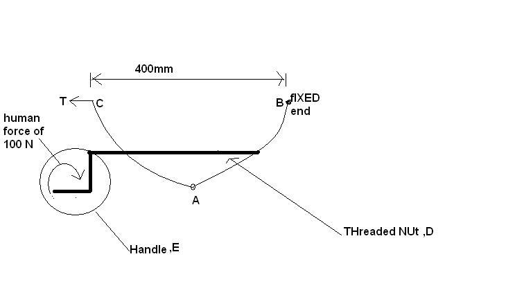

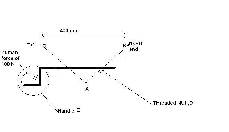

As picture attached .We need to find the dimensions of all the parts that are Pin(A),Jaw(B and C), NUt (D) , Handle (E) .The jaw B is fixed and C is free to move towards B.There is a force T=1779.261 N on Jaw C.Secondly there is a human force involved in turning the handle (E) which is maximum of 100 N and can not exceed it.We need to find the dimensions for all the components discussed , especially the diameter of the threaded nut ,the vertical length of the Handle and the DIameter of the Pin being used.
U can see the mechanism of car jack .its exactly the same just the difference is that tehre are two jaws in place of traingle in car jack.
Well i think if we can possibly relate the work done is covering the distance with the force applied over the handle then we can caluculate the diemnsions of Handle and for the diameter of Nut if we can find its realtion with inertia .
addition in daigram uploaded before so see the new diagram
there is a little inforamtion missing in the first diagram so i have added it in the second diagram attached now.

A little more of correction or can say ease in question
Well sorry for the inconvenience wlel i have modified the image more maybe it could be of little more help
