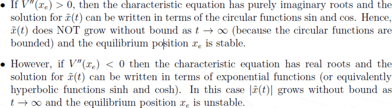

my lecturer had this to say (see attachment)
would you say i have interpreted his notes properly?

You should also change the "circular imaginary function" part. It's the roots of the characteristic equation that are imaginary, which give rise to the circular functions sine and cosine. The functions themselves are not imaginary.

I am pretty sure he is saying if V''(x)<0 its unstable. that's what i said, can you please check again, kindly. as now i am worried :(
I have attached his entire notes, please see pg11, it has the stuff about equilibrium points. as i am not convinced that my statements are exact opposite of my lecturers

Sorry, what you had was correct. I guess my brain stopped working momentarily. If V''(x) > 0, you get stablity, and if V''(x) < 0, you get instability, which is what I surmised earlier (post #5).
Also, now I see where the characteristic equation is coming from.
