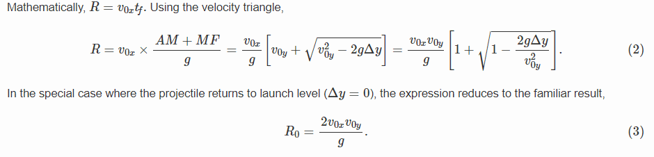

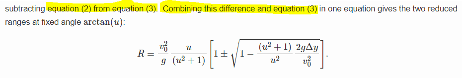

I just have a small question about finding the range of the projectile flying over a slide--why did you add the difference to eq 3 rather than eq2? I would like to know this because I think R_0 is already the range of the projectile which returns to the starting height, and it makes no sense if you add the difference to it. Thanks.

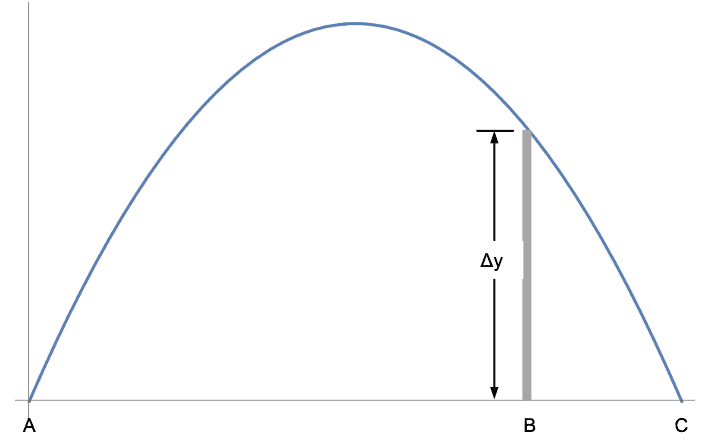

I did not add any difference.
Equation (3) gives ##R_0## and is represented by length AC in the figure below.
Equation (2) gives the horizontal distance to where the projectile is at height ##\Delta y## and is represented by length AB in the figure below.
When you subtract equation (2) from equation (3), you get the remainder of ##R_0## which is the "other" range represented by length BC in the figure below.
I wrote the two ranges in one equation that gives either ##R##. The top (positive) sign is for the longer AB and the bottom (negative) sign is for the shorter BC. That same equation with ##\Delta y =0## gives ##R_0.##
