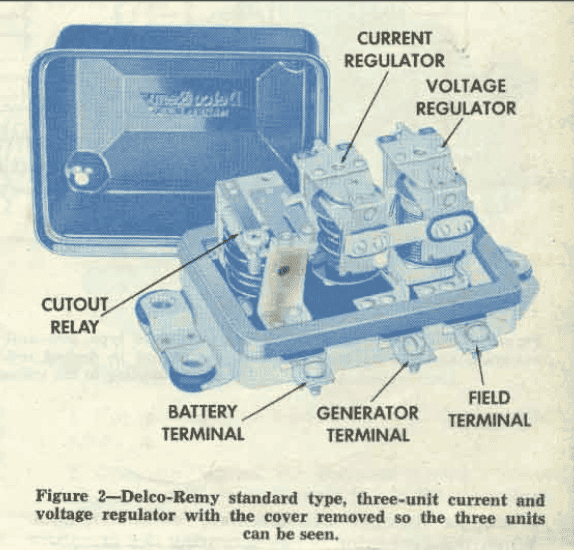

Controlling an old fashioned generator ? Hooowww absolutely Delicious !
Does it have a field?
Great time to learn generator basics.
You can still buy electromechanical voltage regulators. They are really fun, you can push gently on the relays and watch the system work.
Makes the DC machine intuitive.
tutorial on how they work:
(^^^^^That picture comes from here-)
http://www.stinsonclub.org/PublicTech/YahooGroup/Delco-Remy 1R-116 (regulator).pdf
Makes the DC machine intuitive.View attachment 88118
Hi Jim, is there a modern version assembly of the same kind?
will it limit the current?
does it have an on/off switch at X current?
Similar but not exact. Fords of early 70's are probably your best bet.
will it limit the current?That one actively limits armature current by modulating field current. Middle coil does that.
As automakers replaced generators with alternators, then got better with alternator design, it became unnecessary to limit armature current and that coil disappeared from regulators. Alternators are inherently self limiting because of something called "Armature Reaction:". That might be an approach for you to look into.
Alternators, having diodes, no longer needed that reverse current cutout relay either. My 1962 Chrysler had a one coil voltage regulator, as i said Ford regulators s were more complex. and i think limited current for a few years.
Point being - there is a window where you might find a more modern regulator made for alternators that'll still regulate current.
does it have an on/off switch at X current? No, it disallows more than X current by reducing field excitation . Only turn-off function is leftmost coil which disconnects in event current commences flowing into rather than out of the generator. An electromechanical diode, if you will.
old style 3 coil regulators are available brand new but might cost you $50.
I;ve never looked into modern solid state ones because they're not repairable, just replace. Other posters here have suggested approaches to make one, and their skills vastly exceed mine..
If you just switch off at X current, current immediately falls to zero - will you prevent an automatic "switch back on" ? Don't build yourself an oscillator.
