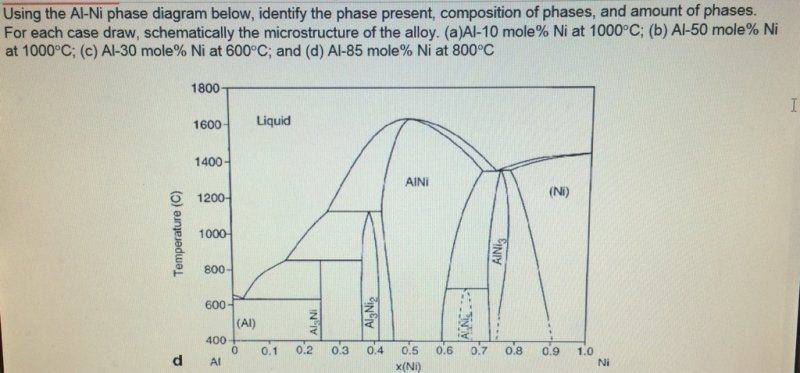

I have no idea how to tackle this. Please show me how to do these problems.
Al-Ni binary phase diagram plotting temperature in degrees C against x(Ni) from Al to Ni, showing Liquid region, (Al), Al3Ni, Al3Ni2, AlNi, AlNi3, AlNi2 and (Ni) phases.

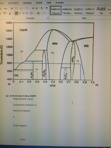

Ok. So I understand how to get the phases present at each stage and I went ahead and labeled where each point should fall on, however, I don't understand how to get the composition of each phase or the amount of phases. Here is what I have so far:
Al-Ni binary phase diagram plotting temperature in Celsius (400 to 1800) against x(Ni) from 0 to 1, with labelled regions for Liquid, AlNi, Al3Ni2, AlNi3, (Al) and (Ni), and points (a) to (d) marked.

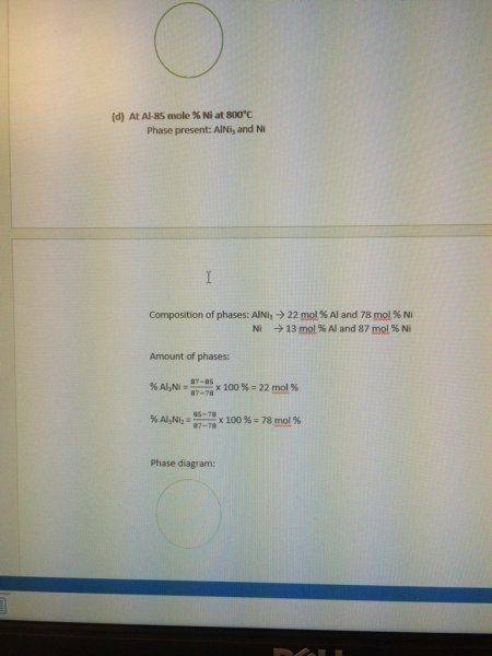

And I was given part (d) as an example but it's honestly made the problem more confusing as I am just given answers and no way of determining them
Handwritten worked solution on a laptop screen for an Al-Ni phase diagram at 800°C: phases AlNi3 and Ni, with composition 22 mol % Al and 78 mol % Ni for AlNi3, and 13 mol % Al and 87 mol % Ni for Ni, followed by lever-rule phase amount calculations.
It looks like there is something wrong with the solution sheet for part d. They correctly identified the phases present, and then calculated the proportions of the phases. But, in displaying the proportions, they mis-labeled Ni as Al3Ni2. They calculated the proportions by drawing a "tie line" and applying the "lever rule." Are you familiar with these concepts?

Yes. I actually just had one of those "aha" moments for the composition while looking at this again, however, the lever rule concept still escapes me
