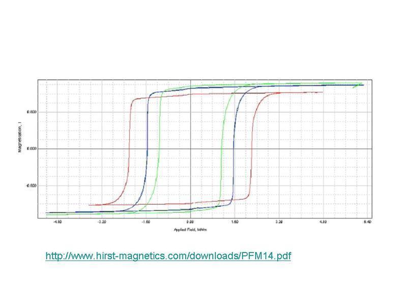

To recharge neo magnets, you should aim for at least 3 megamps (MA) per meter magnetization. See
https://www.physicsforums.com/attachment.php?attachmentid=23832&d=1266698681

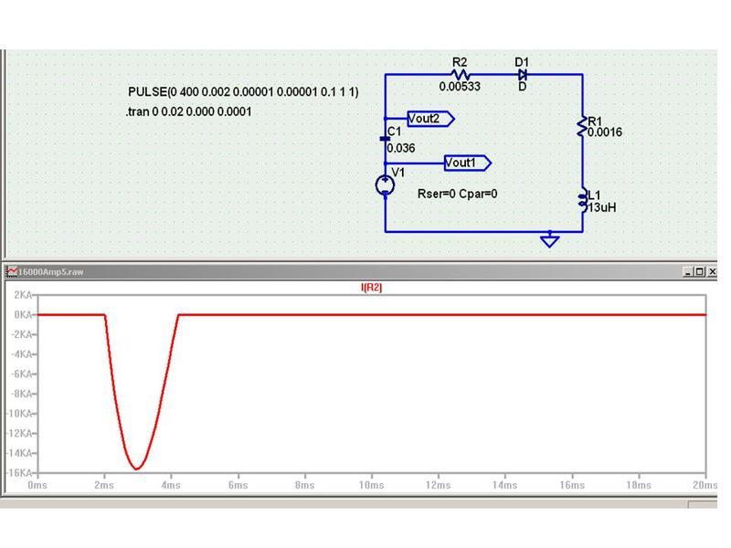

Second, you can use a pulse system as shown in
https://www.physicsforums.com/attachment.php?attachmentid=21794&d=1258147485
This pulse network gives a 16,000 amp pulse through a 13 uH coil. Be careful to design the coil with the correct inductance, or rerun the simulation. Eddy currents may be a problem in the neo magnets, so calculate them to make sure the pulse is long enough. Finally, the series diode has to carry 16,000 amps peak.

Regarding the eddy currents, will they be generated in the coil or in the magnet? coz I know a way to calculate them in wires or thin plates, but I have no idea how to calculate them on a neo magnet.
And in respect of time, how long would it be long enough?

The magnetic field needs to penetrate to the center of the neo magnet. The radial skin depth of the magnet is
δ = [2/ωσμ0]1/2
There is probably a correction for short (finite length) magnets, but I don't know it. Smythe "Static and Dynamic Electricity" Third Edition, problem 24 on page 411 may help (it has the answer).
