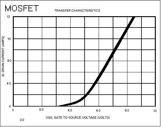

Or you just look up the characteristics in a data sheet:
Graph titled MOSFET Transfer Characteristics plotting ID drain current in amps against VGS gate to source voltage in volts, showing a curve that stays near zero until about 3 volts, then rises steeply to about 12 amps at 8.5 volts.
the datasheet curve only works at one VDS value, usually they give you multiple curves
Yes, but when I tried to copy from a real datasheet it was "protected". So for a real datasheet, search at On Semiconductor or Texas Instruments.
