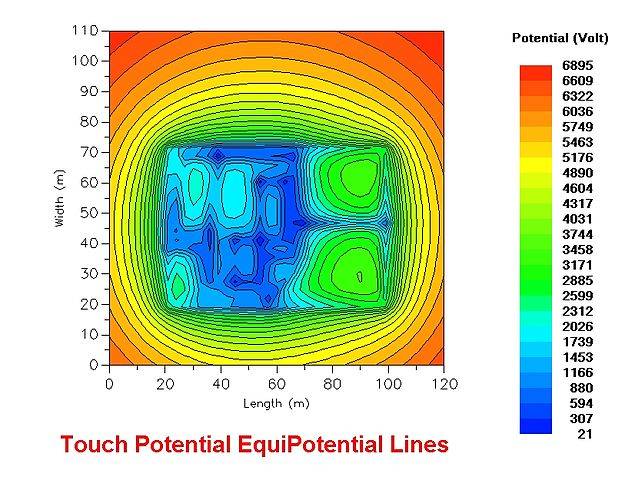

I'm not sure what you mean by "Ground bounce on AC line". If you are trying to simulate earth potential rise, good luck. Here's what the ground potential gradient might look around a substation due to a fault.
