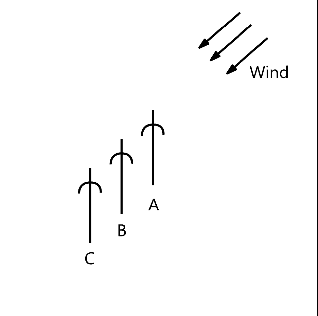

- Question: Which cyclist (A, B or C) profits the most from cyclist slipstream (also called “aerodynamic drafting”)?
- Given: the direction of the wind, the positions of each cyclist; an illustration representing this
- NOTE that I am expected to solve this question conceptually, without using a pen, paper and/or calculator. From personal interest, however, I am also wondering if the problem could be solved concretely. However, the priority right now is, solving it conceptually.
- Perhaps, the drag reduction due to slipstream could be estimated(/calculated) by using the drag equation, which is FD = ½ ρ * v^2 * Cd * A (with FD = Drag force, ρ = fluid density, v = Relative velocity between the fluid and the object, Cd = Drag coefficient and A = Transversal area or cross sectional area)
According to the answer sheet, confusingly enough, the answer is cyclist B. What I can make up from the situation is that cyclist A catches up a significant amount of the oncoming wind force, which favors cyclist B in that he or she has to put in less effort against the wind force. The x as well as y component of the wind force are reduced, meaning that the "v^2" in "FD" and thus "FD" becomes smaller. So far, so clear. However, I do not get it why it is not cyclist C who profits the most of drag-reduction, as cyclist B catches up a great amount of the wind that passes by cyclist A, wherefore C should face the oncoming wind even less than B. Wondering what I am doing wrong. The only reason I can think of is the fact there are three arrows and that that might be explanatory for B profiting more from slipstream compared to C, but I fail to make a logical conclusion.
Might something not be clear enough, please let me know.
Thanks a lot in advance.

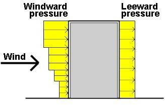

Perhaps think what happens to the airflow behind a solo cyclist. What happens to the airflow behind you if there is someone close behind you?
https://www.physicsforums.com/attachments/230252
Firstly, thank you for the directions.
Behind each solo cyclist a low pressure wake can be expected (I guess this can be referred to as “leeward pressure”, see picture). And if someone is slightly sideways close behind a cyclist, he does not only profit from the slipstream of the cyclist in front of him, but also presses air towards the cyclist in front of him.
However, at the other hand, I can also think of a disruption of laminar airflow, a.k.a. turbulent flow, and in the worst scenario, vortices behind cyclists, which would, I think, have a negative impact on a cyclist that is being straight behind.
Now, trying to relate this to why cyclist b should profit more from the slipstream / drag reduction, I arrive at the following assumption: the extent to which cyclist B profits from cyclist A's slipstream and the forward acting pressure caused by C, must be greater than the friction caused by the disrupted airflow behind A. Whereas, C will be subject to the disrupted airflow created by both A and B and won't have a cyclist behind him pushing air forward on him. So, I think that the effect of the airflow disruption and the absence of air pushing from behind must be stronger than the drag reduction created by A's and B's slipstream.
Am I somewhat on the right track?

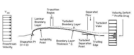

Air does not get "pushed" onto the rider in front of you when you are drafting...
Think also about what happens in swimming workouts and open-water swimming races. Swimmers draft much like cyclists do. As both a cyclist and a swimmer, I know which one of those three positions I'd want to be in... :smile:
Good to know that swimmers also practice drafting. I have been searching on the web using different terms and found out several facts related to my question. Firstly, that it is indeed best to draft immediately behind a swimmer, instead of at the so called hip-position (http://www.220triathlon.com/training/swim/how-much-time-does-drafting-save-when-swimming/10378.html). I learned that wake is actually a disturbed flow of fluid / recirculation of fluid caused by the fluid moving around the body of the swimmer. The same is also applicable to aircraft and the effect is way stronger for air. The reason of wake seems to lie in viscosity, and it often seems to go along with flow separation. I read, that when the flow is massively separated, a reverse flow region is induced behind the body where the fluid is moving back toward the swimmer/aircraft. It seems to me that, that is the phenomena that causes the slipstream / drag reduction that the person/vehicle experiences... Most logically, the slow down of the fluid at the back of the vehicle due to viscosity and the low pressure area created should be the factors responsible for reducing drag behind there. However, the cyclists are not positioned directly behind, but rather more leftward-behind, so I have difficulties with concluding if the same applies then, and if so, how. And the last thing I fail to understand is, how the wind (which comes from northeastward toward the cyclists) effects the amount of slipstream each cyclist experiences and why cyclist B is more in favor compared to C. My logic tells me that C should be more in favor as it is more "protected" against the wind.
And one more thing that creates a contra-feeling, is that the disturbance of air in wake regions, must produce drag, which should be in disadvantage of the person/vehicle behind. It is even known that vortices of aircraft are extremely dangerous for the aircraft flying behind and thus should be avoided.
The last piece of info related to the subject I found that might be helpful is that birds use a similar method when flying in a v-flight; in that case the birds manage to reduce the downward acting weight force by making use of the updraft created by the front bird's flying (https://en.wikipedia.org/wiki/V_formation).
I found a lot of info, yet can't manage to give a concrete answer to my topic question. Might I be confusing different terms or am I maybe relating them wrongly.
Hopefully, you can direct me through this, I really wonder about your valuable opinions

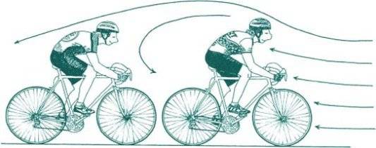

I just found this picture, which is an explainer for how drafting works for cars. Its clear to me that the vehicle in the middle profits the most from draft. Do you believe the same principle will work in the case of the diagonally arranged bikes (see uppermost post) which are traveling not entirely head to tail as depicted above? If so, what is the explanation for it? I tried to draw out the direction of the airflow and its effects on the bikes - see attachment - but after research using several terms and visualization of the situation, I still don't manage to see why bicycle B should benefit more from slipstream. Hope someone can provide directions.
That picture and airflow are for streamlined cars going 150mph+ with specific body shapes. IMO, that does not apply to bicycle riding or racing.

I'm not sure if anyone has given the answer you're looking for, but in case not, let me give it a shot. If there were just one cyclist, they would have to cycle against both the air they are hitting by going forward, and from a low pressure that forms behind them that tries to "pull" them back. The second cyclist in line wouldn't have as much of that negative pressure behind them because the third cyclist would be riding in the slip stream of cyclist B, and therefore would "break up" the air flow behind cyclist B. So cyclist A is pushing against the wind, and cyclist C has the negative pressure behind them "pulling" them back. Cyclist B wouldn't have either (or would at least have less of both forces).

Questions such as this beg for assumptions to be made, some off the cuff from intuition, some from experience, and some coming from a knowledge of the "equations." The vortex shedding explanation that you proposed led me to wonder if riders ever experience the Karman Vortex Street ( vortex alternating from side to side ), or would they ever know owing to action od pedaling. Some thing to think about, but I do doubt if it would ever be found in any literature on cycling.
I completely agree with you. The question leaves a lot to be desired. That is why I keep trying to explain that I was not trying to argue my point, or claim that my answer was definitely the correct one. I was simply offering a viable reason as to why the "correct" answer was "B". I keep getting people trying to shoot holes in my answer like "in a line of rides, the greatest benefit is actually towards the middle/back of the pack, not the true middle", and things like that. I am not trying to debate the pros and cons of the question, or the actual benefits one would experience while riding (versus theoretical ones), or anything like that. I am simply trying to provide a reasonable explanation as to why the correct answer is "B". So while all of the points everyone have made are valid, let me clarify by stating that I am making a few basic assumption, like the answer has to be A, B, or C, and can't be something like "B and a half", and the riders are moving at a constant velocity (acceleration = 0).
Physicsterian said:
Firstly, hi and welcome! Thank you for your input, every new view helps me in strengthening my general look at the subject, thus I am thankful for it.
I had come across the same theory for in-line constructions. However, I really wonder about whether or not the same of what you described is applicable to the Echelon setting with crosswind being present (?). Berkeman, Haruspex and Cwatters have put a lot of effort in helping me, and we indeed arrived at some important conclusions. However, because of the practical complicatedness of the matter, I think we all still have some doubts to a certain extent. Curious what your view is on the Echolon setting. I trust you on your word and profession, and will search further based on the search terms I am able to filter out in order to find sources. Help by getting views is my priority; I rather hear a new view without a source, than that you keep it for yourself, because you can't find or don't have time to provide a source. However, might you find a source, it would be of awesome additional value of course.
Absolutely. As for the vortex shedding/drag created by pressure differential between air in front of and behind the rider, it is the same concept as the airfoil image and car example given in previous answers.
As for the stacked formation, the cross wind on each rider can be broken down into force vectors that would be down and to the left of the riders. How large in magnitude each of those vectors are is a factor of the direction (or more accurately, at what angle) the wind impacts them. However, regardless of the angle, there is some downward (in relation to the image posted, not downward toward the pavement) force. So the wind is going to impede their ability to traverse forward. Also, the vortices that are shed will come off on the back left side of the riders. So their staggered positioning will protect them better against the crosswind shown than an in line formation would.

Consider this, at low Reynold's number, say 1,
the flow would be expected to follow each rider's and bike contour, so there is no benefit from either drifting position. The drag is due to skin friction as there is no separation of the flow. As we move towards increasing airspeed, the pressure drag becomes more dominant. Eddies form behind the object but tend to follow closely. With more airspeed, the eddies break off and flow downstream. And etc.
For a cylinder in an airflow we can follow this,
http://www-mdp.eng.cam.ac.uk/web/li...al_dvd_only/aero/fprops/introvisc/node11.html
Since a rider on a bike is not a cylinder but a conglomeration of shapes, that is just for illustration purposes.
And for one cylinder only.
Add a second, a third, or more, and the flow pattern changes.
Some symmetry arises with multiple riders - three is not enough.
I think the experimentalists have a one up upon the theorists for this problem.
Even then there seems to be some disagreement whether or not the leading rider benefits, at least inline, let alone in this configuration with drifting.

From the standpoint of a person who rides bikes, you're probably correct - there is little to no difference. From a physics standpoint, even at low speeds, there may be little difference, but there's almost assuredly not zero difference. Since this question was asked from a physics standpoint as opposed to a practically standpoint, I stand by my answer.
And even if you said it had almost zero benefit, you can at least say there's no way it could make position "B" worse than position "C". So if you're asking which one benefits the most, again, I stand by my answer.
I should point out
I said at low Reynold's number, the position matter's less, and as low as a Reynold's of 1, position is irrelevant.
As the airspeed increases, drifting does come into play.
Rider's and bikes in a real race would have a Reynold's >> 1
