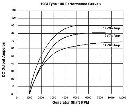

Below is a sample alternator performance curve. Note that the key input parameter is not revolutions but revolutions per second, and the key output parameter is not joules but joules per second (watts=joules per second=volts*amps).

sir, in graphs that you send what is the meaning of 12volt

ok sir , but what is meant 12 volt in graph?
It means exactly what it says. 12 volts. What good is a specification sheet if there is no reference to voltage? According to the graph, when the shaft speed hits 5000 RPM the alternator is able to supply about 90 amps at 12 volts. This is about 1080 watts. If the voltage were specified at 5 volts then the output would only be about 450 watts. The voltage regulator that exists in the alternator is responsible for maintaining the voltage at around 12 volts. Typically an automotive alternator regulates at about 14.25 volts.
Sir ,it means voltage varries as the rpm varries (1000 to 5000) or alternator does not supply the current at single voltage (12 v) with varrying rpm?
A modern automotive alternator with a built in voltage regulator will supply a constant voltage over an RPM range. The current supplied depends upon the load. As per the graph, there is only a certain RPM range that the alternator is able to supply a given amount of current.
