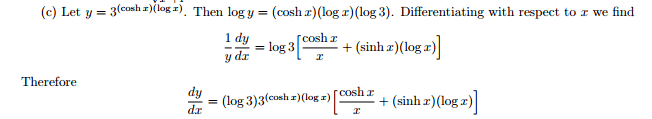

Chain Rule: dg/dx = du/dx . dv/du . dg/dv

The derivative of [itex]3^v = e^{v \log 3}[/itex] is [itex](\log 3) e^{v \log 3} = (\log 3)3^v[/itex], not [itex]3v^{v-1}[/itex] which appears to be what you have.
If you set [itex]v = u\log x[/itex] then you want to calculate [tex]\frac{dv}{du} = \log x + \frac ux \frac{dx}{du}[/tex] and the [itex]\frac{dx}{du}[/itex] cancels with [itex]\frac{du}{dx}[/itex] when you apply the chain rule.
Differentiating functions in exponents is straightforward: By the chain rule, with [itex]a > 0[/itex], [tex] \frac{d}{dx} a^{f(x)} = (\log a)a^{f(x)} f'(x).[/tex]
