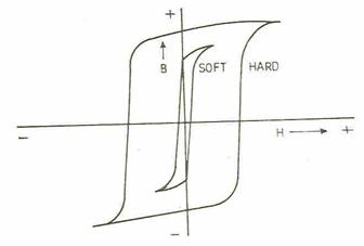

Wide/Narrow Hysteresis loops, what's the difference?
When calculating the work done to magnetize a ferromagnetic material, calculating the hysteresis loop is the right way?
I know the narrower loop(soft) needs less energy(work) to magnetize or demagnetize it is that true?
That's why it's best to use Soft ferromagnetic materials to minimize losses in energy etc...?
What is the importance of coercivity? It determines the "area" of the hysteresis loop?
Iron = 160 A/m
samarium-cobalt = 3.2 x 106
Likes alihashemi9091
Yes, the area inside the hysteresis loop shows exactly the amount of the work done in one cycle. :wink:
Iron = 160 A/m
I'm not familiar with coercivity … i thought it was just another word for "softness"? :confused:
