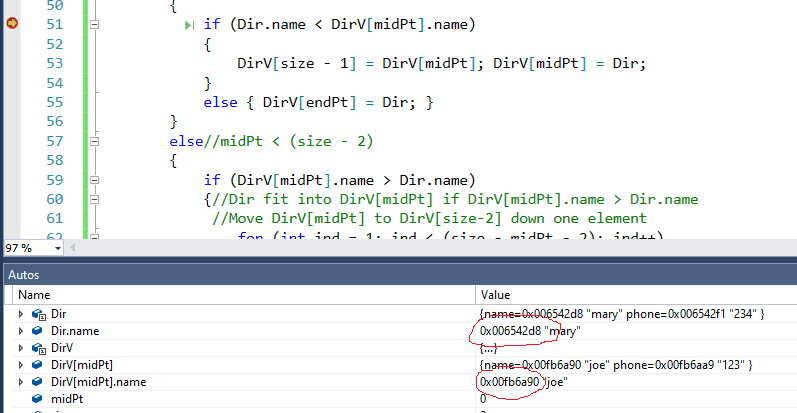

I run into something strange when I step through debug. This is the program to add names one by one, and each name entered, it will sort and put in ascending order into vector DirV[]. I cannot explain why the if statement in line 51 doesn't work.
First name I enter is just 'r', I just put a single digit number for the phone eg. 5. Second name is 'e', third name is 't'.

I put break point at line 51. This will break only after I enter the third name 't'. I verified after the program stopped at line 51 using immediate window. Dir.name='t', and DirV[midPt]='e'. Line 51 is if(DirV[midPt].name > Dir.name) which should be FALSE. The program should jump to line 61. BUT instead, it goes to line 54 as if it's TRUE!
I don't know what to make of it, I must be missing something. Please take a look.
@jedishrfu hints at what your problem is.
In line 51, Dir.name is NOT 't', and DirV[midPt].name is NOT 'e'. Both Dir.name and DirV[midPt].name are arrays of type char, which really means they are pointers. In your comparison if (Dir.name < DirV[midPt].name), what you are comparing are the two addresses, not the characters at these addresses.
When the breakpoint at line 51 is hit, the Autos window shows the values of Dir.name and DirV[midPt].name - 0x006542d8 and 0x00fb6a90, respectively. The first address is smaller than the second address, so the if clause is executed.
The value of Dir.name, 0x006542d8, is the address of the first character in the string - 'm'. The value for DirV[midPt].name, 0x00fb6a90, is the address of the first character in that string - 'j'. The comparison is on the addresses, not the characters at those addresses. If you want to compare two C-strings, you should use a standard library function such as strcmp(), in the header file cstring.
Screenshot of a Visual Studio debugger showing C++ code at line 51 with a breakpoint, and the Autos window listing Dir.name as 0x006542d8 "mary" and DirV[midPt].name as 0x00fb6a90 "joe".

AH, I see!
This has nothing to do with the vector! It is the .name part that is a c-string.
can you verify whether I am right instead of me experimenting with it:
C++:
if(strcmp(Dir.name, DirV[midPt].name) > 0);
for name in Dir > name in DirV[midPt]
C++:
Yes, that's right. Also, you can check the documentation, such as here: http://cplusplus.com/reference/cstring/strcmp/. Look in the Return Value section.

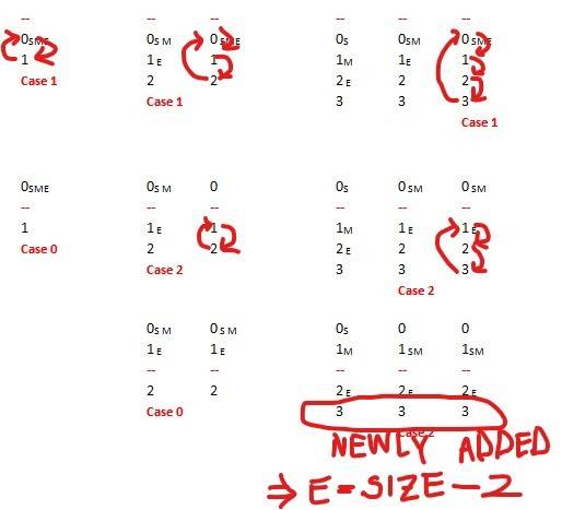

I finally completed this sorting program, I am NOT sure it's worth the trouble. The idea sounded much better in my head. I think this program is faster than Selection Sort. Because I sort every time I add a name, the vector DirV[] is always sorted. So when I add a new one, I can easily find the position to fit the new element, move the ones below down one position and copy the new element in. It should be faster and easier than Selection Sort. But the code is definitely longer due to different requirements when size = 1 and size = 2 comparing to size > 2.

Thanks guys for the input. I know I should not spend so much time in reinventing the wheel designing the sort algorithm...BUT, I just feel like having some stimulation on the old brain. It is NOT easy, I spent like a week on this. But I really feel I learn a lot. Call it stupid sort or whatever, I did it.
I know it's pointless to optimize the speed, I just did it for the hell of it. The program ask to input information into each structure, then it immediately sort and store in the vector. So the elements of the vector are sorted already. Any new element added will be sorted and added in. Sounds easy enough, but I can assure you it's a whole lot harder than bubble or selection sort and a whole lot less steps. I don't know any other sorting method, so I just made this up. Call it stupid sort or whatever, I did this on my own.
My program not only sort the last name, I sort the first name also. I can input as many names as I want as I am using vector of structure to give me the flexibility. I made so much mistakes it's not funny. Things that work most of the time and fail occasionally. I don't know how many time I stepped through the program in debug. Finally I stopped and actually work out a table that really help me in seeing all the potential error. This is my program that ask you to input last name and first name, it will first sort the last name and then sort the first name within the same last name. Also tracking the element number of the vector array.

This is a big step in completing my Directory program that store name, phone, address and email address. Also it uses Classes. This program really make me practice all the things I learned.
Attached is my table I used to write this program. I spent a few hours typing this in, that really helped me to see my bugs.
Thanks for all the help.

I like the challenge too. It's one thing to learn all the names and their meanings, it's another thing to let the rubber hit the road. It really started out thinking that was easy, you have a vector that is already sorted, how hard can it be to add a new one in the right place? NOT! It sounded so easy to set the starting point, the end point and middle = ( start + end)/2 and if new one is smaller than middle, end = middle, middle = ( start + end)/2 and do it over...... WRONG! That's how I spent 5 days going no where. Finally I created the chart, keeping tract of the start (S), middle (M) and end(E) as you see in subscripts in the word file. Then you can see how they being set. They don't behave the same depending on the position and the length of the original vector( ' --- ' in the chart shows where the new name fits in the existing vector). Took me 4 hours to generate the file, then one day to implement and debug to make it work. this is live and learn.
This reminds me in kick boxing, people keep admiring the round house kick and side kick that look so hard. They think front kick is easy, just pick up your foot and kick.....WRONG! Round and side kick has a steep learning curve, but once you get good, you are good. That stupid front kick looks so easy, believe me, it takes YEARS to master it to generate the power. You wonder why in MMA and other kick boxing tournaments seldom use front kicks? It's NOT easy to generate power. Last thing you want is you land a kick and the opponent just look at you!
Anyway, I am happy, I almost going to give up and put in the selection sort...But I guess it's not in my nature. Now that my study schedule is out the window delayed by this! 😊
The next step is displaying a range of selected names, choose one I want to delete and resort the file, that complete the sorting. Last step is to implement this back to my main program of Directory of names with address, phone, email and store in file using Classes.

Ah, I see what you have done. Rather than sorting, you have maintained the vector in a sorted state by inserting each new element into the right place. The algorithm you have used is called binary search if you want to look into this further.

Not much point in sorting a vector that is already sorted. There are better ways of organising this kind of data in a tree as I think I mentioned above, but this is a whole new subject that will take some time to master.

Again you won't need to resort it, will you?

I cannot find a better word than "sort"! Yes, the vector is sorted, just want to insert the new element into it. I read the name binary search and tree in later chapters. I just decided to be adventurous and do it. I don't want to wait and wait until I learn all the tools before attempt doing something. That's part of the adventure!
