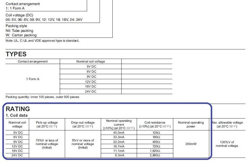

I meant "I want to learn how to determine what gauge I need" Does this mean I could use any combination of length/gauge that would reach 100 ohms? How do I figure out how many ohms are required?davenn said:reread what I wrote
you should be aiming for a coil resistance of around 100 Ohms
A 12V relay coil is typically around 250 - 300 Ohms and more than 1000 turns

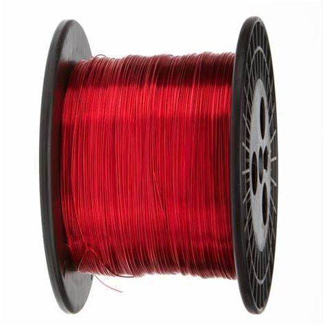

You maximise the amp·turns by filling the largest possible winding cross-section.
If the winding is 75 mm long and 5 mm deep it has a section of 5 * 75 = 375 mm².
You can probably fill π/4 ≈ 80% of that section with round copper, the rest being insulation and air.
So the section of copper is 375 * 0.8 = 300 mm².
The ampacity of copper magnet wire is about 10 A/mm².
For a one turn winding that makes 300 * 10 = 3000 amp·turns.
It remains 3 kA·turns for a full section of any diameter copper wire.
If you know the DC voltage available you can select wire that is thin enough to limit the current by resistance, to the ampacity of that sized wire.
The attached file contains the calculations needed to evaluate different copper wire sizes.
Adjust the wire diameter to have actual current less than ampacity.

Here is the direct way of finding the wire diameter.
The wire_diam in mm = √ ( Cu_resistivity * Cu_ampacity * volume /voltage /100000 )
Where;
Cu_resistivity = 1.715 ' The resistivity of copper in ohms·metres·10-8.
Cu_ampacity = 10 ' The maximum current in amps per mm2 of copper.
volume = π * ( Rout2 - Rin2 ) * length ' The volume of the winding in mm3.
voltage = the DC voltage connected to the coil.

Could one of the reasons of my magnet being much weaker that projected was that it was winded poorly? The magnet made almost no force. I winded all 160 feet around a small spool and I did not do a very good job. All of the winding was clockwise but it is a little uneven. Thank you for the detailed explanation of ampacity and how I can use it.Baluncore said:You maximise the amp·turns by filling the largest possible winding cross-section.

If you scramble wind the coil, the same length of wire will have a few less turns, so the amp·turns will be slightly less. I do not think that is the real problem.
I think you need many more amp·turns, or a magnetic core.
If the former was aluminium it will act like a shorted secondary winding. You should have an insulated gap along the wall of the tube to prevent the shorted turn.
If the former was an iron tube it would greatly reduce flux through the air core because the flux would follow the iron path rather than the air path.
What material is the former?
Can you reduce the inner diameter by 1%, and so reduce the area of the former by 2%, to get a greater field density?

The wire is wrapped around an aluminum tube. This tube has a 1/2 diameter and is hollow. Ferrous items are supposed to be able to move through this tube and be affected by the magnet, if that makes sense. If i were using an iron tube would it not just turn the entire tube into a large magnet? The force of the magnet is supposed to be concentrated in one section of the tube.Baluncore said:If you scramble wind the coil, the same length of wire will have a few less turns, so the amp·turns will be slightly less. I do not think that is the real problem.

You have a long magnetic coil. You will only notice a change when the magnetic material is near the ends of the coil.
The thick aluminium tube wall is a shield that will slow any changes within the air core. The presence of ferrous material in the tube will distort the field, but that change will be delayed by the aluminium tube.
Maybe change to a plastic tube, or cut an insulating slot along the aluminium tube in the region of the coil.
We do not know what you are trying to do so it is difficult to suggest more practical alternatives to your concept.
