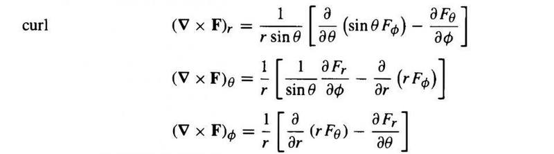

Using equation from the book ( del cross F) r
I get zero.

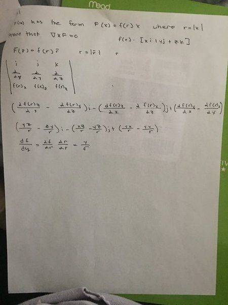

Have my answer for part a uploaded

The formulas for ##\nabla\times## in polar coordinates make calculations with radial vectors easy because all the hard work has been done in deriving the formulas. If you have not been given those formulas, and hence are required to derive them if you use them, there is no point in using them because the work involved in deriving them is greater than the work involved in just doing the whole calc in Cartesian coordinates.
Given that, the simplest way is just to do the calc in Cartesian coordinates. Since the usual coordinate names in Cartesian are ##x,y,z## I suggest you instead call your point ##\vec r##. Then the coordinates of ##\vec F(\vec r)## are ##(f(r)x,f(r)y,f(r)z)##, writing ##r## for ##\|\vec r\|##.
Then use the Cartesian formula for ##\nabla\times##:
$$\nabla\times\vec u=(\partial_x,\partial_y,\partial_z)\times (u_x,u_y,u_z)=(\partial_y u_z-\partial_zu_y)\hat i
+(\partial_z u_x-\partial_xu_z)\hat j
+(\partial_x u_y-\partial_yu_x)\hat k$$
where ##\partial_x## denotes ##\frac{\partial}{\partial x}## and ##u_x## is the ##x## coordinate of ##\vec u##.
The calc is quite short.

Your notation is terrible. It appears you are mixing up F and f in A. Apparently what you are calling x is what would normally be denoted ##\vec r = \langle x,y,z\rangle##. And in your work you use x as above and also as one of its components, which is very confusing. Also, your posting images instead of typing your work makes it difficult to edit and violates forum policy.
I wouldn't normally bother to answer such a post, but it's a slow day here so...
I think your question is, given ##\vec r = \langle x,y,z\rangle## and ##r = |\vec r| =\sqrt{x^2+y^2+z^2}##, and ##f(r)## is a differentiable function, calculate ##\nabla \times f(r)\vec r##. Write that out carefully and you should get the zero vector. If you get stuck and don't get that, type your work here for additional help.

Of ##\phi## is a scalar and ##\vec V## is a vector, a standard formula (which you can prove yourself) is$$
\nabla \times \phi \vec V = \nabla \phi \times \vec V + \phi ( \nabla \times \vec V)$$
