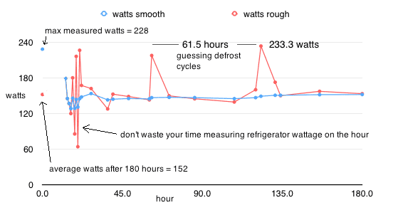

@T=180 hours(7.5 days), the energy consumed was 27.69 kwh, which corresponds to an average power of 152 watts.NTL2009 said:If you are using a Kill-a-watt meter, or equiv, couldn't you compare overnight kWh to daytime kWh? You'd need to manually log the kWh and time before bed and in the AM, but a week's worth of data should average out the defrost cycles.
Great devices!Trainee Engineering said:using Kill A Watt...
I've learned a lot about my refrigerator from the data I've collected over the last week.

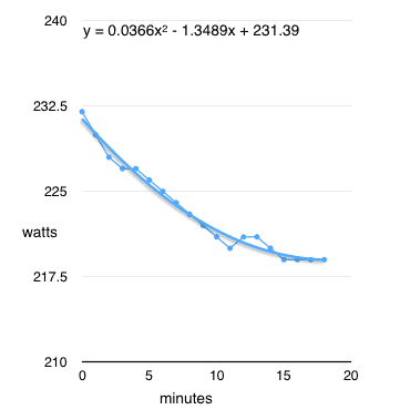

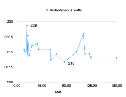

One peculiarity during this experiment, was that my refrigerator operated at between 210 & 228 watts.
It wasn't until I accidentally triggered it to turn on, and start recording data every minute, that I found out why.
For some reason, instantaneous power consumption goes down with time, after the compressor has started running.
And I think I may have captured the defrost cycle:
"watts rough" is the the wattage between readings
"watts smooth" is the wattage from time = 14 hours
Entertaining numbers:
On or about t=20 hours, I went out for lunch, in an attempt not to booger my "DON'T OPEN THE REFRIGERATOR DOOR!" experiment, and spent $7.35 for lunch.
From my extrapolation of data so far, it costs me $13.55 to run my refrigerator for a month.
Conclusion: Eating out, even at Taco Bell, is kind of expensive.

This can be calculated with the the data from the first line of mine that you quoted;" ...which corresponds to an average power of 152 watts"Trainee Engineering said:hmm, $13.55, may I have the kWh? because price per kWh from one country to another is different, but kWh remains constant anywhere. a bit curious about the energy consumption when door not opened.
152 watts * 24 hours / 1000 = 3.65 kwh/day
So your refrigerator uses less than half what mine does.Trainee Engineering said:average consumption per day is 1.3 - 1.5 kWh.

OmCheeto said:For some reason, instantaneous power consumption goes down with time, after the compressor has started running.
The temperature difference decreases over time with the operation of the cooling device. The power needed to operate the compressor decreases with a decrease in temperature differential. Quod erat demonstrandum.
