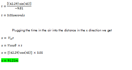

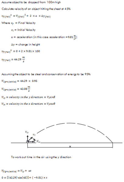

I am investigation exclusion zones on building sites,
I have attached my attempt at working it out, The answer that I get is about 4 times greater that the preferable answer.. I am unsure what factors I could use to reduce this?
As I read your work, you have used theta ("##\theta##") as the angle at which the steel ball rebounds. You have assumed that theta is equal to 45 degrees. But per the givens of the problem, the steel plate on the ground is at 45 degrees. For an energy-preserving bounce, the angle of incidence (measured from the perpendicular) will be equal to the angle of reflection (again, measured from the perpendicular). With that in mind, can you calculate the angle at which the steel ball will bounce from a 45 degree plate?
What would the plate angle have to be to get a bounce at a 45 degree angle?
would that be 135 degrees?

If a steel ball falling vertically hits a plate that is angled at 45 degrees from the horizontal, it strikes that plate at an angle that is 45 degrees away from being perpendicular, right?
At what angle will it rebound?
will it be perpendicular to the ground? I.e. no y direction?
Parallel to the ground, rather. Yes, it will have zero velocity in the y direction.

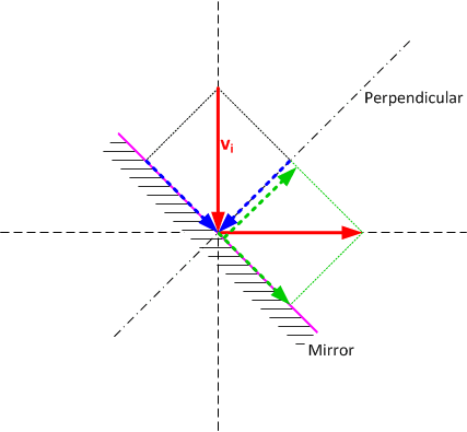

Dear thara,
Make a drawing !
Incoming velocity vi has a component along the mirror (left blue) that is unchanged (lower green)
And a component along the perpendicular (right blue that bounces (is reversed): upper green.
Two green components add up to outgoung velocity (right red).
For your exercise (:smile:) it might indeed be more sensible to let the mirror be at 22.5 degrees wrt horizontal. Make a similar drawing to convince yourself the outgoing velocity is then at 45 degrees.
And yes, in such a case you indeed get a considerable horizontal distance of travel !
More, in fact, than you calculated: in the y-direction the vertical velocty at impact is not zero but the negative of the initial velocity. As you can see from your own drawing.
It is a nice exercise to show that this 22.5 degrees indeed gives the worst-case range :rolleyes: .
