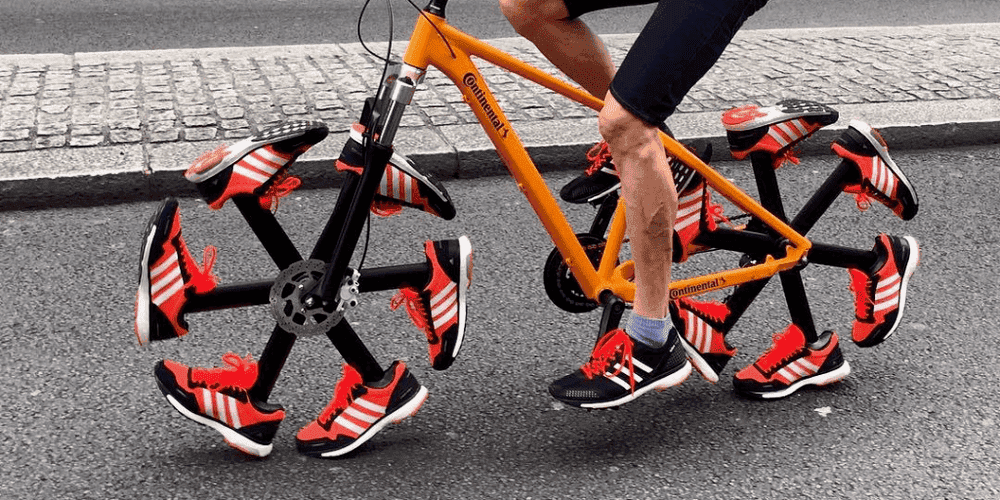

Using walking as an example, they are two cases to consider:
  1. You can push forward your foot and drag it on the ground, and the kinetic friction creates a sliding force you must fight back;
  2. Or you can push rearward on the ground with your foot - via static friction - to propel yourself forward. That is the same as rolling.
The following image should help you visualize the link between rolling and walking:
  • Wow
  • Love
Got it thanks. Can I look at it as it's hard to slide using legs and move forward, rather than walking and moving forward?

When you slide your foot, you're going against [kinetic] friction, therefore adding a moving force that requires energy to fight back.
When you walk (or roll), you're using [static] friction to brace yourself and propel your body forward. But since the friction force doesn't move with respect to the ground, it doesn't require any energy from your part.
