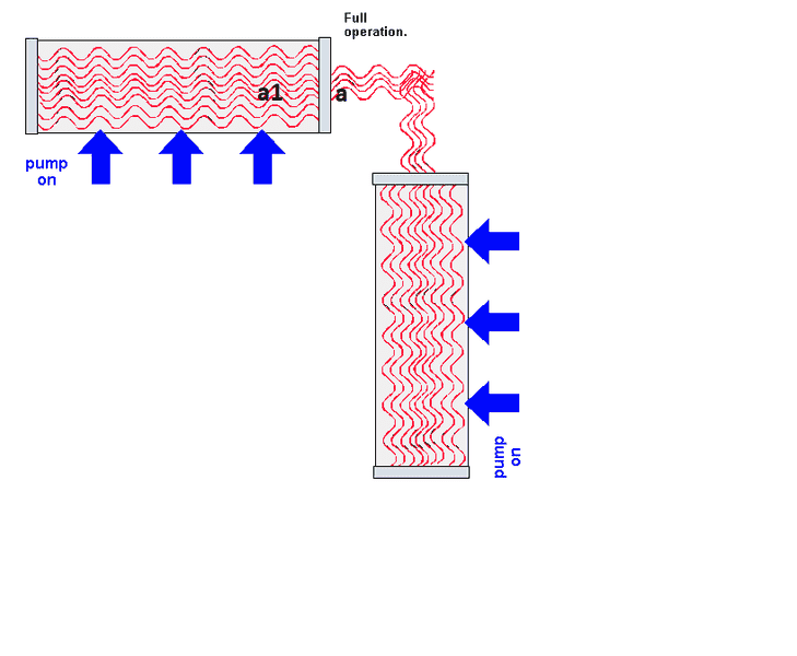

With "what kind of intensity" I am asking for the best way to measure the effect of a laser hitting another laser. I want to know with a sensor that if the another laser is crossing over the laser or not, in aerospace.
Thank you for your time. it is limited for all of us.
Can i have sensor in place A (from pic) measuring the laser beam and detect the crossover of the another laser.
EDIT: what kind of sensor.
Lasers don't hit each other; light waves pass through each other. You can, however, measure the "intensity" as power absorbed by a photodetector placed where they intersect. Is that what you are looking for?
Lasers don't "hit" each other. Two laser beams crossing each other will just pass through each other. There is no special effect that you could measure.
If you measure the intensity directly at the point where they cross, you'll measure the sum of the intensities of the individual laser beams.
The sensor at "a" won't be influenced by the vertical laser.
