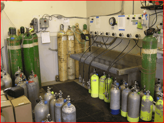

As another example to help show how the pressure and temperature of an ideal gas are related, consider that when you go to the scuba diving store to get your air tank refilled, they often put it in a tub of water while they pump up the pressure of the air in the tank. Can you comment on why they do that? :smile:

im guessing it would be to keep it at a constant tempurature, since a pressure increase means the molocules are moving faster?
Yes, basically to keep the tank cool while it is filled. Otherwise it gets a bit hotter than you would like. Also, in case of an accidental rupture of the tank (which is rare thankfully), the water would help to dampen the explosion some.
A very small amount, perhaps. The energy stored in the compressed air in a diving cylinder can take out the back end of a car. 300bar for a compressed volume of 10l is a lotta Joules. :nb) I would guess it could empty a small swimming pool.
Pressure testing is always done by filling the cylinder with water under pressure; the amount of energy stored in an almost incompressible fluid is almost zero.
