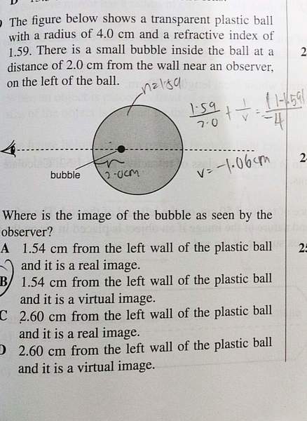

the ans is B for this question
my working is 1.59/2.0 + 1/v = (modulus of 1-1-59) /( -4 )
my v is -1.06cm. which is 1.06cm to the right from the tleft wall of plastic ball

What question? Did you forget to attach something

It's going to awfully hard for anyone to give you any help based on the total lack of a problem statement.

her's the question
you could draw a ray diagram to locate the image.
Sorry, I have found my mistake finally
