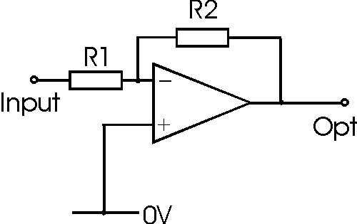

Hi,
The book I'm reading references the fact that the impedance seen by the inverting input of an inverting amplifier is just the two feed back resistors, R1 and R2 in parallel.
Circuit schematic of an inverting op-amp amplifier: input through R1 to the inverting (minus) terminal, R2 from output back to the inverting terminal, non-inverting (plus) terminal tied to 0V, output labelled Opt.
I'm having trouble seeing this. I understand how the basic voltage divider with one end at Vin and the other at ground can be replaced by its Thevenin equivalent but in this case it seems like the tail of R2 is connected just to some arbitrary output terminal. In fact ground is actually connected to the non-inverting input and it seems to me there's no easy way to create a Thevenin equivalent of the driving source without examining the opamp's innards.
The book goes as far as to redraw the inverting amplifier with the Input voltage in series with (R1,R2 parallel) connected to the inverting terminal with nothing connected to the opamp output so we are essentially have open loop gain. Surely this cannot be equivalent? To give some context, we are looking at the effects of input biasing currents so the Input voltage is grounded. I apologize if this last paragraph is confusing since I can't supply a picture.
My main question is just in what sense is it true that the impedance seen by the inverting input of an inverting amplifier is just the two feed back resistors, R1 and R2 in parallel? I'm struggling to reconcile this with my understanding of the more traditional voltage divider.

You are probably reading this in the context of DC off-sets, and being told that for optimum results, the OP-AMP's (+) input should be returned to ground via a resistor equal to the resistance seen by the (-) input of the OP-AMP. As always, to find the Thévenin impedance you short out the voltage sources, in this case Vin and Vout, and you are left with two resistors in parallel.
BTW, R1 is not a "feedback resistor". :approve:

The input impedance of your circuit is R1 unless the amplifier output is saturated.
Adding a resistor from the + input to ground eliminates (in theory) output offset voltage due to input bias (not offset) currents. Input offset current = i02 - i01 where i01 and i02 are the bias currents flowing into each op amp input. Bias current = (i01 + i02)/2. You can eliminate bias current output voltage offset but not offset current output voltage offset.
To understand how a resistor from the + input to ground = R1||R2 eliminates bias current output voltage offset, label the - and + inputs as e1 and e2 respectively. Ground the R1 input and e2 and draw currents i0 flowing into the + and - inputs. Write nodal equations to compute the output Eo. Remember that e1 = e2 (no input offset voltage assumed). You should get Eo = + i0*R2.
Then put a resistor at the + input to ground = R1||R2. Now e2 = -i0*(R1||R2). Recompute your output Eo remembering that e1 = e2. You should get Eo = 0V.

It has nothing to do with a potential divider. Set all voltage sources to 0V, position yourself at the (-) terminal of the OP-AMP, and you see 3 resistances to ground all in parallel: R1 to ground, R2 to ground, and the infinite impedance of the OP-AMP's (-) input.
Also how exactly will this eliminate the offset dc voltage caused by input bias current?
I'd say rude man has explained this better than I could. It makes identical the impedances of the circuits feeding the input transistors forming the differential input of the OP-AMP block.
