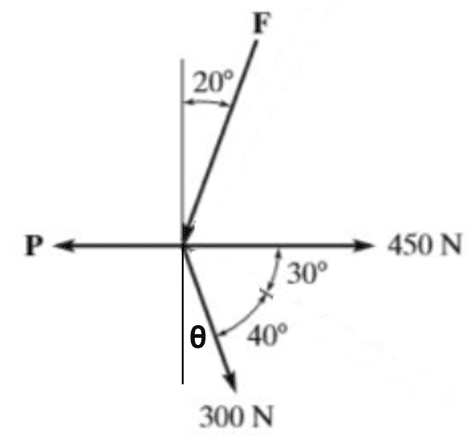

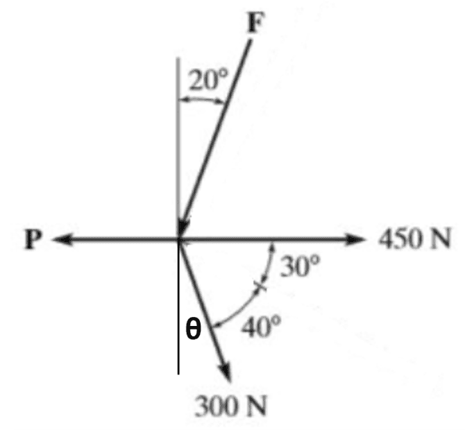

Write the two equations of equilibrium (Do not solve)
((Newton's second law))
I can't find the angle between F(Big arrow in my drawing) and the y-axis!
I am terrible in geometry, what book do you suggest to me as Mechanical Engineer to get better at geometry??
This is my attempt to solution and the figure:

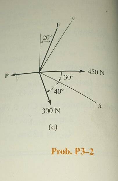

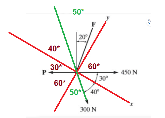

Are the x and y axes supposed to be orthogonal in that drawing? And what is that other axis, maybe the z axis? And is orthogonal to the x and y axes? That's a very confusing diagram, IMO...
@Mohmmad Maaitah
Note that your attempt to solution and the figure do not fully match.
Since you have the paper in fornt of your eyes:
Could we consider vectors P and 450 N colinear and both perpendicular to the reference line for 20 degrees?
The y and x axis are perpendicular
I think.

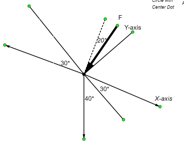

what are the green dots????
Never mind them, it's the drawing app start and end of the line

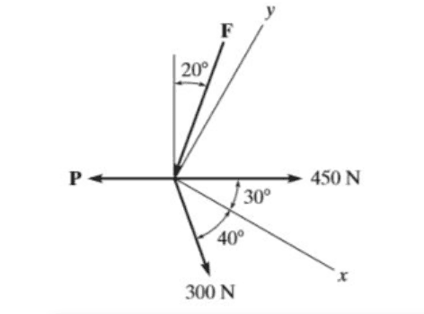

This one must be better! there is zero information given in the problem
Forget the ##x## and ##y## axes in the problem because they're included purposely to confuse you!
Find the angle ##\theta## above and then resolve the various forces into horizontal and vertical components.
Okay this is helpful for other problems but this one asked me to do it using the X and Y axis!
Homework Statement: Write the two equations of equilibrium (Do not solve)
Is this the full homework statement? Where does it say anything about the ##x## and ##y##???
It only says that the sum of forces on each of the X, Y axes is zero.
Yes, but if the sum of forces on the ##x,y## axes is zero, then those forces also sum to zero on any set of axes that are rotations of those axes, like the horizontal and vertical directions in my diagram. In general, vector forces summing to zero does not depend on any particular choice of coordinate axes: it's true for any and all of them.
Please indulge me! Before using this busy diagram, first solve for the total horizontal and vertical forces using my diagram, set those totals to zero and write the resulting equations. (After that we can worry about finding what that solution looks like in x, y coordinates!)
Reply
renormalize said:
Please indulge me! Before using this busy diagram, first solve for the total horizontal and vertical forces using my diagram, set those totals to zero and write the resulting equations. (After that we can worry about finding what that solution looks like in ##x,y# coordinates!)
On the horizontal axis I get: 450-P+300cos70*-Fcos70*
On the Vertical axis I get: -300sin70*-Fsin70*
solving for F I get F=-300N
solving for P I get P=655N
Sorry for not using LaTeX for now.
Don't the vertical components involve the cosine of 20 degrees, not 70 degrees? And does F and P refer to the magnitudes of the force vectors F and P? If so, how can F be negative?

This problem is P3-2
RC.HIBBLER Statics.

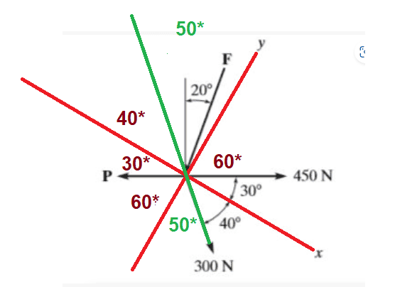

If still required, can I answer the original question...
Use your Post #16 diagram.
What is the angle between the green line and the blue vertical line?
Can you now find the angle between F and the y-axis?

Sorry about the confusion. See if this helps.
Let ∠A be the angle between the blue vertical line and the Green force .
1) Force P is horizontal, so the angle between P and the vertical blue line is 90º.
2) On the diagram, this 90º angle is shown to consist of 30º, 40º and ∠A.
∠A + 30º +40º = 90º which gives ∠A = 20º.
Once you know ∠A you should be able to work out the angle between F and the y-axis.
Reply
I guessed that the Blue vertical line and the P force are perpendicular but couldn't make sure of it, that is because there is nothing to confirm it!
Now I get it.
Thanks all.
