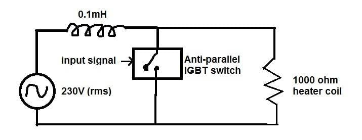

I dug around and have come-up with a simple solution to my problem.
My gross need was to have a variable heater power with as good a power factor as possible.
So, I came up with this simple boost converter as my solution,
Circuit schematic: 230V rms AC source with a 0.1mH inductor in series, feeding an anti-parallel IGBT switch in parallel with a 1000 ohm heater coil, all on a shared return line.
When the switch duty-cyle is around 1%, the effective rms voltage across the Heater is same as the source voltage, i.e. 230V rms. At such condition, the heater power = 230^2/1000 = 52.9 watts.
This is the minimum achieveable power.
Now, as the duty cylce is increased, the effective load RMS voltage is also increased.
I simulated this ckt. using L=0.1 mH, and the pulses to the switch applied at 50Khz,and at 99% duty cycle.
I got,
Effective Vrms across heater = 2624V !
Heater Power = 6.8 Kw
Rms Source Current = 32.81 A
power factor = .91
So, it appears (after some playing around), that I can achieve power control from 52 watts to around 7 Kw with very good power factor.
Only bad thing, I find in this scheme is that, I need heater coil rated for some 3 Kvs and the switching device needs to be rated for same KV as well.
What are other draw-backs, and what could be better options?

It seems quite weird to me that, I can't find similar scheme for variable heater power with good power factor, but that works on lower voltage levels.
I came across SMPS with active/passive Power Factor Correction, but all of them seem too complex. Isn't there any simpler scheme, like the one I came up with?

One of us is confused. For any pure resistance load like a heater , KVA = KW because there's no phase shift.
And as you pointed out, since I (load) = I(source), KW(load) will = KW(source) because when current is zero , Volts X Amps = 0 in both of them . So even YOUR power factor P(load)/VA(source) will be one.
(AHA - that's it - zero in denominator while switch is open. )
Can you figure out which of us is the confused one and clarify?

Hi jim,
Peoples sometimes really don't give a damn, if they feel the other person is talking nonsense or simply if they couldn't quite get what they want to tell. I really appreciate the attitude you have shown here.
But I am pretty sure, you are at the confusion here.
The thing in Bold in above quote would only apply if the circuit contained only linear elements like resisters, inductors, and capacitors. However, we have here, a Resistance which is placed behind a switch. And that makes this circuit non-linear, and that makes your statement inapplicable.
To demonstrate how switching load gives poor power factor, let's look at a simple half-wave rectifier supplied Resistive load.
_____|\|____/\/\/\/\_____
AC........|
|_____________________|
Say, AC source voltage = 10 V peak
Diode drop = 0V
Heater resistance = 10 ohms
So, during the positive half cycle, current flows and is in-phase with source voltage and has a peak of 1A.
During the -ve half cylce, current = 0.
Since in a whole cycle the current isn't sinusoidal, we can't simply apply P = V*I*cos(phi) formula, because phi is defined only for sinusoidal current.
So, let's work out the power factor of the load in this configuration.
Whatever be the wave-shape of current, the power dissipated in resistive load is Irms^2*R
So, in our case, I is sinusoidal for +ve half cylce with amplitude 1A and 0 for negative half cycle.
So, we can compute Irms = 0.5A. (college mathematics)
So, P = Irms^2*R = 0.5^2*R = 2.5 watts.
Now, VA input from source is simply, VA = Vsource_rms*I_source_rms
Obviously, I_source_rms = I_load_rms = 0.5A
Vsource_rms = 7.07 Volts (for 10V peak sinusidal wave)
Therefore, VA = 7.07*0.5 = 3.535
Thus we have, pf = 2.5/3.535 = 0.707
In another way, P_load = Irms^2*R = V_load_rms*Irms
Also, VA = V_source_rms*Irms (remember, I_load_rms = I_source_rms = Irms)
Thus, pf = V_load_rms / V_source_rms
I hope I made sense.

I think really this should be looked at as more of a harmonics problem - the Generator will will have a PF rating - but that is a specification point - as it really can supply X amount of VA ( Apparent Power) - But most of the switching schemes - will produce ugly ( high harmonic) current wave forms. This is more damaging to the generator than the power factor.
The Simplest I can think of is an IGBT (mosfet will not work due to integral body diode) - this is two IGBTs back to back - or antiparalel in series with the resistor. These will not have the normal Antiparallel diodes you see in most IGBT set ups.
Now using an AC Voltage sensing circuit - I would PWM fire the IGBTs - 10 to 20 X carrier ( 50 or 60 Hz) should be fine - I do not even think you need to apply a carrier - but you may want to average the V Ac ( otherwise it will turn on on the peaks - when you really want it on ( Pulsing) for the whole cycle. You do not need to be in the 50kHz range - as IGBTs have much higher switching losses than MOSFET - literally around 2kHz will be fine and allow a small IGBT to work. The PWM firing will make for a clean SINE current. This is much more complicated than a buck circuit - but a buck circuit is really a DC-DC converter - the diagram above will not work for AC. ( It would only "work" in one direction) .
Indeed the phase control SCR supply for our control rods used for source a generator run at less than 10% of its nameplate amps for that reason.
