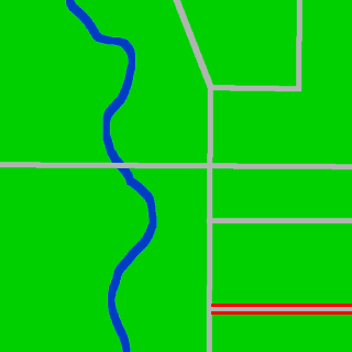

But isn't the diagram a face/side/slice of the block?
Do you understand that if I draw two maps of my town with north in different directions then the streets will not point in the same directions? Do you understand that this does not mean that there are two sets of streets pointing in different directions in reality? Do you understand that I've chosen only to represent the ground on the maps, even though there are tunnels underground all over the place here? That I know that those tunnels are there, and I've chosen not to draw them because right at the moment I don't care about anything not in the 2d plane of the surface of the Earth?
If so, what's so hard about the concept of two different maps of a 2d slice through spacetime? They just look different because you've used different projections to draw them, the same as I would have used different rotations to draw my maps.
