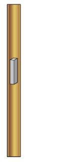

Have you seen this experiment with the magnet dropped down a copper tube?...the effect is awsome.
If the bottom of the magnet is a N pole then current will flow around the copper tube ahead of the N pole to repel the magnet. So a N pole is induced
The top of the magnet is a S pole so the induced current in the copper tube above the magnet will flow to attract the magnet. So a N pole is again induced.
The induced current flows in the same direction, following the falling magnet, trying to stop it moving because this is what causes the changing magnet flux through the conductor.

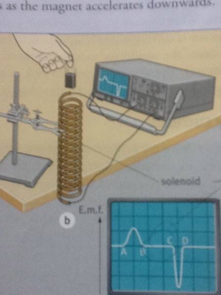

oh, ok, so at what stage in the cycle will the EMF induced be zero:

#52
Where did you get that trace from?
It is what you would get if one end of the magnet was dropping through a coil of wire.
Imagine a N pole approaching the coil and emf will be induced to oppose (repel) the falling magnet pole. when the pole passes through the coil an emf in the opposite direction will be induced to oppose (attract) the falling magnet pole.
The emf increases and takes less time because in falling the magnet pole is accelerating.
This is not exactly the same as the magnet falling in the copper pipe because both poles are in the pipe together (unless the magnet is very long)

so what would the graph look like for the magnet in the tube?
also, take a look at this animation: http://regentsprep.org/Regents/physics/phys08/clenslaw/default.htm
it seems to contradict you. The impression I get is that this animation ignores the "pole" of the magnet and takes into account the amount of flux linked.
The lower coil has an increasing magnetic flux DOWN so I want to oppose this so I point by thumb UPWARD and I get a current counter-clockwise
The upper coil has a decreasing magnetic flux DOWN and I want to oppose this so I point my thumb DOWN and get a current clockwise.
This therefore implies that if the magnet is WITHIN the tube, the EMF is zero for all that time. right?

so if I was to trace a graph of EMF (Voltage) against time (seconds) what would it look like?

A horizontal line with an S shaped wiggle in it.

here is a drawing of the falling magnet as it passes through a coil. as the blue end passesthrough you will get the blue part of your trace.
as the red end passes through you will get the red part of the trace.
The size and width of each part of the trace are to do with the fact that the falling magnet is accelerating.
As the middle section of the magnet passes through there is a flux but it is not changing !
Try to picture the field lines for a bar magnet, in the centre they are parallel

I'm not sure whether this needs clearing up but, for the original falling magnet situation: The RH rule, as we first come to it, is about a wire with two ends across which you measure an emf. When you have a loop or a tube the situation is a bit different. The direction of the induced emf is around the circumference of the loop (a short circuited ring) rather than along the length of the tube (Motion, EMF and Field are all at right angles). The emf and hence the current around the circumference will vary along the length of the tube - having maxima, clockwise and anticlockwise at the places where the poles happen to be passing. The maximum magnitude of the current will depend on the resistivity of the metal tube.

I have just re-read this. What did you mean by "in the tube"? The emf will be different at all points on the tube. The Mean EMF (in time and distance) will be zero, of course - or there would be an endless DC component.
We know there is a braking effect (practical evidence) and this 'proves' that the current must be different at all parts of the tube. Why? Because a field that attracts the N pole must be the opposite to a field that attracts the S pole. As it falls, the magnet must be encountering this arrangement of fields all the way down so the induced field must be 'chasing' the magnet and this will involve currents changing (in time and position) as it falls. The EMF to produce these currents must be just right to ensure this happens.

I mean as it is falling through the tube
two currents, in different directions, will be produced
hence cancelling - net emf is zero so graph should look like:
/\_________________
right??

How are these two currents "cancelling"? They are in different places and at anyone time. It's like saying AC 'cancels' because there are as many positives as negatives. I still don't think you have the right picture of what's going on. Currents are flowing all over this tube in different directions and they are all changing in time. There is no one, single, value of current. You could produce a similar effect if your tube were to be replaced by a series of insulated copper rings, fixed one on top of another.
Have you heard of 'eddy currents' which are induced in iron cores of motors and transformers? They are the same phenomenon as in the tube. By laminating the core, you introduce insulating layers between the leaves of the core and eliminate / reduce these eddy currents. If you milled a slot down one side of the tube, the EMFs would still be induced but currents wouldn't flow so the magnet would fall unimpeded.

when the magnet falls let's say it falls with north pole first:
the entire magnet is in the tube so:
the bottom of the magnet is increases the flux for the tube (imagine the tube as circlets of wire) beneath it. so a current is induced to repel the magnet (upward). for this to happen it needs to be a north pole so current = anticlockwise
the top of the magnet is falling away and the tube needs to create a north pole (downard) so the current flows clockwise.
thus the NET current is 0 hence the net emf should be zero too, no?

well there will be zero overall emf as per the graph?
so the graph would look like:
  • #86

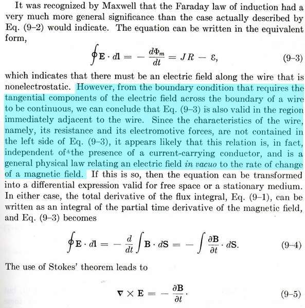

I dug out my old textbook (Panofski and Phillips) and found this passage, which, to me, suggests that the effect is there with or without a wire being present. That confirms my opinion that the emf is there without any current being needed.

going back to the EMF qustion could you quickly look at post #85 and tell me if the diagram there seems correct
  • #93
Sorry- I though I'd already replied. Must have killed that window without actually posting. The diagram shows what happens for a coil (not tube) and that the peak EMF is greater when the magnet is falling faster. The area under both of those humps would be the same aamof. There is no current (scope is high impedance) so virtually no braking effect in this case.
Are you confusing the two situations or is this just 'for interest'?

right?
I really don't understand what picture you have in your head. What currents "cancel". You are not using terms that I can understand. Do you mean that the mean current is zero?
When the magnet falls through a copper tube the currents are very high and vary, as I have already said, over time and distance.
  • #96

  • #97
see diagram
  • #98
I disagree. The author presents his claim that E and B are there with or without a conductor. I agree with him so far. Then he writes the closed path line integral of E*dl, which is voltage, and relates it to B and area. But the integral E*dl, requires a specific path to have a value. It is a closed loop integral.
If the voltage is there in an imaginary closed loop in space, will charges in free space circulate in said loop? I don't think so. If a voltmeter, VM, were to have its probes placed in 2 points in empty space, would it read a non-zero voltage in the presence of a non-zero E field? What do you think?
The author correctly points out that E & B are there even in empty space. He then concludes that emf which is the integral of E*dl, must also be non-zero, which makes me wonder. In a physical conductor immersed in said fields, charges would move. In space they move, but not in a closed loop like they would in a conductor. Lorentz force is there, and the charges in free space do indeed move, but the path changes. The emf due to varying fields is path dependent. Since the path taken by free electrons in space differs from that taken in a conductor, the voltages are not equal.
To say that a voltage exists in free space can be supported by Maxwell et al. But I don't think it is the same value as the case w/ a conductor because electrons would move along a different path, and voltage value is path dependent. A CRT is an example. Two parallel plates have a charge, and an electron beam is projected between the plates. The electrons get attracted towards the positive plate and away from the negative plate.
In free space, at every point between the plates, it is safe to say there is indeed a potential. But the E field here is static. I've already stated that under static conditions, current can exist w/o voltage and vice-versa. This does not negate my earlier statement involving dynamic conditions.
Same problem, but the field between the plates is ac, sinusoidal for example. The sine curve plate voltage results in a sine curve E field. There is indeed a potential in between the plates, sine curve in nature. But the plates carry a current to maintain the sine E field. Free electrons in between the plates move back and forth, which is ac current.
Dynamic conditions, i.e. time-chaning, are different than static. No ac voltage exists w/o ac current. That is my point. In free space there can be a voltage w/o current, but only static, not dynamic.
As far as joules per coulomb goes, the voltage across the car, bumperto bumper, is the joules per coulomb of charge transported from bumper to bumper. If a resistor were connected across the bumpers, large in value so that its own current generates a B field too small to cancel the external B field, then the voltage is equal to the joules of energy per coulombs transported through said resistor.
Is this clear? Do I need further clarification? BR.
Claude
