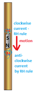

here is a drawing of the falling magnet as it passes through a coil. as the blue end passesthrough you will get the blue part of your trace.
as the red end passes through you will get the red part of the trace.
The size and width of each part of the trace are to do with the fact that the falling magnet is accelerating.
As the middle section of the magnet passes through there is a flux but it is not changing !
Try to picture the field lines for a bar magnet, in the centre they are parallel

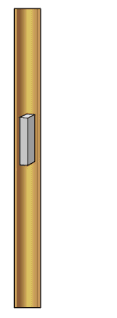

I think people are missing the question I had:
if the tube was A LOT longer and the magnet was v. short would the emf be 0 for all the time the magnet was in the LONG tube?
  • #68
What EMF where?

I have just re-read this. What did you mean by "in the tube"? The emf will be different at all points on the tube. The Mean EMF (in time and distance) will be zero, of course - or there would be an endless DC component.
I mean as it is falling through the tube
two currents, in different directions, will be produced
hence cancelling - net emf is zero so graph should look like:
/\_________________
right??
  • #78

when the magnet falls let's say it falls with north pole first:
the entire magnet is in the tube so:
the bottom of the magnet is increases the flux for the tube (imagine the tube as circlets of wire) beneath it. so a current is induced to repel the magnet (upward). for this to happen it needs to be a north pole so current = anticlockwise
the top of the magnet is falling away and the tube needs to create a north pole (downard) so the current flows clockwise.
thus the NET current is 0 hence the net emf should be zero too, no?
