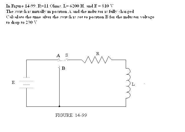

Hello,
I was wondering if I could get some help on the following questions,
First of all let's me explain...I am a high school student who is trying to learn the basics of electrical engernerring on the the side, some day I hope to attend college,and study this field, but at the moment I have an old engineering textbook I got from local libary, and I try to solve the questions...BUT I DO NOT KNOW HOW TO SOLVE THESE EQUATIONS, I have looked the internet through for some input on the formulas to use with Inductance, but find there's too much Algebra involved,without actually giving me the formulas I need!
I would appreciate if someone could look at these questions, and give me some advice on how to solve for each one, and what formulas to use to find the answers, Again I do not attend college, still in grade 10, if possible the answers to each question would be great with the equations worked out so I can follow it would be great!
But I am hoping someone will give me some time on the following questions.
I look forward to your reply.
Thanks
Wolf

Test

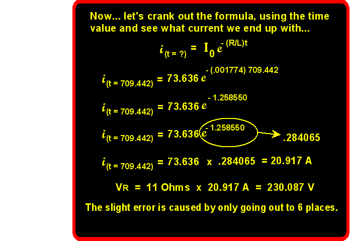

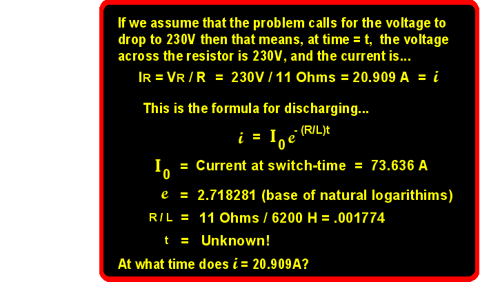

R=11Ohms
L=6200 H
E=810 V
The switch is intially in position A and the inductor is fully charged. Calculate the time after the switch is set toposition B for the inductor Voltage to drop to 230V
Voltage Loss=E*e^(-t/Tau)
230V=810V*e^(-t/(6200H/11Ohms)
0.283950617=e^(-t/563.6363636)
t=-563.6363636*ln(o.283950617)
t=709.59 or rounded off=709.60 Seconds
Any commets would be appreciated
Wolf

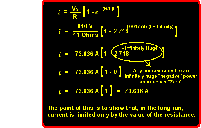

Ok, forget what I said about your R/L being off by ten. I read your R=10Ohms as R=100.

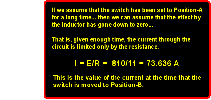

the yellow text said:
If we assume that the switch has been set to Position A for a long time... then we can assume that hte effect by the inductor has gone down to zero
That's what I was saying. Eventually the inductor acts like a short circuit, so you can just draw a wire through it. Then you only need to worry about the resistor.
The equation for current matches with the one I got.
I'm confused. Are these the solutions? Or your work? What exactly are you looking for now? I'm sorry for using calculus, but I just wanted to show you where it all comes from.

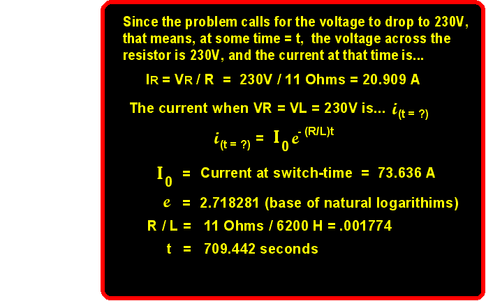

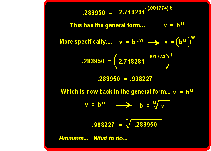

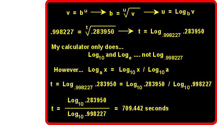

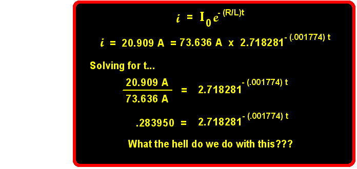

So that's your workings using my formula? Now I'm not so sure of my work... I think I may have used the wrong initial conditions to find the constant. Although it matches the equation you used in the earlier post, so I don't know. I should probably mention that I don't actually know much about EE, and I should probably step down and let somebody else solve the actual circuit.
But I can say a few things about the math.
When you have
V_1 = V_2 e^{st}
There's no need to replace e with 2.71... and do all that other fancy stuff. You said your calculator can do log base e, so use
log_e(\frac{V_1}{V_2}) = log_e(e^{st}) = st
As for digits of precision, it's best to carry the symbols through as far as you can. If you can get an expression for t in terms of all the given parameters, you juts put in those nice round numbers and the calculator will keep all the extra digits for the intermediate compuations and your answer should be more accurate.
For example, if I use
t = -\ln(\frac{V_{given}}{E})\frac{L}{R}
I get t = 709.59278...
Just by plugging 709.59 into this
V(t)=Ee^{-Rt/L}
I get V = 230.001
So by using symbols as long as possible, you preserve accuray.
Symbols also help you from making mistakes by dimensional analysis. If I get an equation that says i(t) = (V0 + V1/R)*exp(t), I know something is wrong because V1/R is current, but V0 is voltage. And I can't add a current and a voltage. But if you just had numbers there, you would never know you had a mistake.

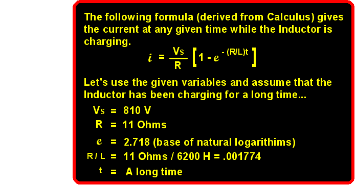

Anyway, now to the current problem. Since the other equation I got was for the switch open initially, that should work here. So,
i(t)=\frac{E}{R}(1-e^{-Rt/L})
I think the equation you have there is for the voltage across the resistor.
According to my equation,
V_L=Ee^{-Rt/L}, and you have V_R=E(1-e^{-Rt/L}), and we know that VR+VL = E, so adding those two together does indeed give E.
You could also say that the voltage across the resistor must be the voltage from the source minus the drop across the inductor, and just by looking at the equation you can see that those are the two terms in it.
But that's ok, because we know that the sum of all the voltages around the circuit must be zero, and E is constant, so if the inductor voltage drops by V0 volts, then the resistor voltage must increase by V0 volts. So you could use either equation to find the time it takes for a change in voltage of some amount to happen on either element.
So do this problem exactly as the one before. Plug the given voltage value into the equation for VL, then solve for t, and convert that to taus.
Alternatively, if you want to use the VR equation, since the inductor voltage starts at E and drops to 120, the change in voltage is (E-120), and as I said before, a change on the inductor will have the same change on the resistor, so plug VR = (E-120) into your equation for resistor voltage and see if you get the same answer. That will be a good way to check if everything is making sense.

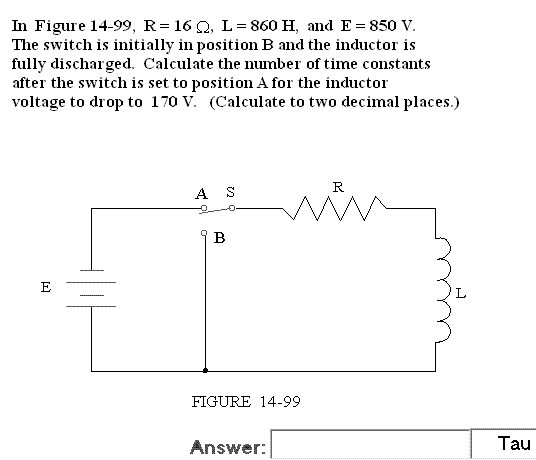

Peavey_Wolfgang_200,
There are only two forms of the solutions to the differential equations for these first order circuits.
First order circuits are those that contain only one capacitance or one inductance, and are called first order because the differential equation that describes their operation is "first order". You don't have to worry about that at this stage (although it will be relevant when you come to study these circuits in an engineering degree).
What is important is that the current, or the voltage, with either go up or go down, and that tells you what the solution looks like. Those that go up look like v(t)=V(1-e^{-t/\tau}) and those that go down look like i(t)=I.e^{-t/\tau}. These equations don't allow for the cases where the levels don't start of finish at zero, so it is easier to use the general form of the solution, which covers all cases. The general form of the solution is
x(t) = x_{final} + (x_{initial} - x_{final} ) e^{(-t/\tau)}
where x is the variable that you are interested in (voltage or current). The value of \tau depends on the capacitance or inductance in the circuit and the total resistance seen by that C or L during the change (sometimes some resistors will not be involved after a switch changes position). For an inductive circuit \tau=L/R and for a capacitive circuit \tau=RC. (You should be able to work out why the L and C are on the top in these equations, and why the R changes position).
In the problem posed,
\tau=L/R=860/16=53.57 seconds
v_L(t) = 170 = v_L_{final} + (v_L_{initial} - v_L_{final} ) e^{(-t/53.57)}
\Rightarrow 170 = 0 + (850 - 0) e^{(-t/53.57)}
\Rightarrow 170 = 850 e^{(-t/53.57)}
\Rightarrow 170/850 = 0.2 = e^{(-t/53.57)}
\Rightarrow ln(0.2) = -t/53.57
\Rightarrow (-1.609)\times(-53.57) = t
\Rightarrow t=86.22 seconds, or t=1.61 \tau
If you use this equation all the time, all you have to do is work out the time constant and the initial and final values (which you have been doing anyway) and plug them in.
On the number of decimal places ... the resolution of your answer is bound by the number of significant digits in the information you start with. In the case you have been given, the resistor is only given as two digits, which would suggest that there is error in the third digit (it was not given as 16.0 ohms). This means that the third digit of your answer will have error in it, and it is not useful to record any extra digits. Thus I gave the answer as 1.61 \tau rather than 1.609 \tau or anything else. (Of course, if your examiner says "calculate to the fifth decimal place" then you have no choice).
Hope this helps. (When you do the engineering program you will have to solve the differential equations so that you know how to handle second order circuits, with both L and C ... but leave that until you have to do it.)

R = 19 Ohms
L = 770 H
E = 8900 V
The switch is initally in position A and the inductor is fully charged. Calculate the resistor voltage 42 sec. after the switch is set to position B (Answer must be in Volts)
R = 24 Ohms
L = 8700 H
E = 720 V
The switch is initially in position B and the inductor is fully discharged. Calculate the time after the switch is set to position A for the resistor voltage to rise to 610 V ( answer in seconds)
R = 25 Ohms
L = 9000 H
E = 750 V
the switch is initially in position B and the inductor is fully discharged. Calculate the time after the switch is set to position A for the resistor voltage to drop to 160 V ( answer in seconds)
Could you please show me what formulas to use to solve for the above following.
Thanks!
WOLF
