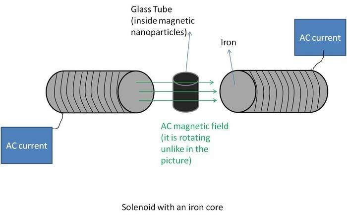

Hi, I want to heat magnetic nanoparticles in an AC magnetic field. I need a uniform and a magnetic field about 15- 25 mT ) . I have thought about some designs, can you tell me which one is the most suitable design for creating a uniform alternating magnetic field? I need this system for magnetic hyperthermia experiments. (A cancer cure using magnetic nanoparticles)

Diagram of a solenoid coil wound around a cylinder, with an AC source, showing outside and inside views; the inside view has an iron core at each end and a glass tube with magnetic nanoparticles between them, with arrows for the AC magnetic field along the axis.
Diagram of a solenoid with an iron core: two wound coils, each labelled AC current, with a glass tube containing magnetic nanoparticles between them and green arrows showing an AC magnetic field, labelled rotating.
Diagram of two parallel rectangular plates connected by a loop of wire to an AC current source, with green arrows between the plates labelled AC magnetic field, and a dark cylinder placed between the plates.
