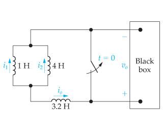

Circuit schematic of a black box connected through a switch labelled t = 0 to two parallel inductors, 1 H and 4 H, with currents i1 and i2 and a series 3.2 H inductor carrying i0 and voltage v0 across the box.
V_o varies as V(t) = 2000e^(-100t) volts for t > 0
i1(0) = -6A
i2(0) = 1A
thus
i0(0) = 5A
Find i0(t) for t > 0.
I found Leq = 4H
V(t) = L di/dt
I separated variables and integrated, got 5e^(-100t)
but the software is telling me it's wrong... supposedly the answer is 5e^(-.1t) and I'm not exactly sure how...
thanks
They change the units of "t" to milliseconds. Their answer should have specified the units if not using SI.
