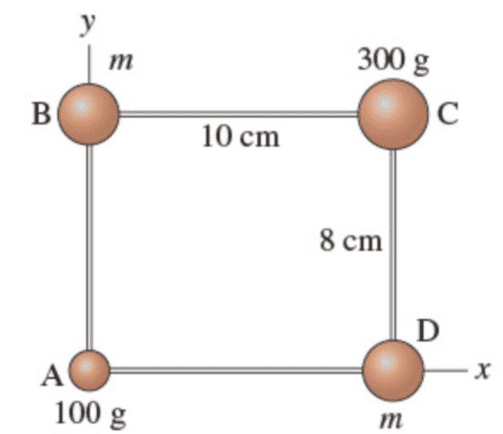

The four masses shown in (Figure 1) are connected by massless, rigid rods. Assume that m = 230 g. Find the moment of inertia about an axis that passes through mass A and is perpendicular to the plane of the image.
Ia = kg * m^2
I found xcm = 6.2cm, ycm = 4.9cm, but am unsure of how to tackle the inertia part of the problem.

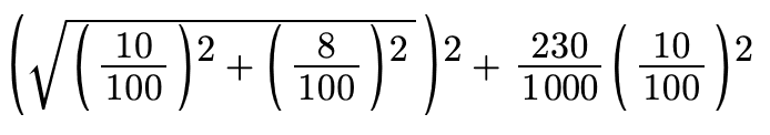

So I did I = Ia +Ib+Ic+Id. Since it's rotating through mass A, I set Ia = 0. I then did I = (.5)(230/1000)(8/100)^2 + (.5)(300/1000)(sqrt[(10/100)^2 + (8/100)^2)])^2 + (.5)(230/1000)(10/100)^2
I got that I = 0.004346 kg * m^2
Does this seem right?
Or I suppose I shouldn't use the .5 so
I = (230/1000)(8/100)^2 + (300/1000)(sqrt[(10/100)^2 + (8/100)^2)])^2 + (230/1000)(10/100)^2 = 0.008692
It doesn't seem right. Why are you multiplying each term by 0.5? Please post your equations in symbolic form then substitute the numbers at the very end. If you don't know how to use LaTeX for posting equations, click on the link "LaTeX Guide", lower left.
Still incorrect. There are three masses to consider, so there are three terms to add. I see only two. Also, only one mass is in your expression, the one in the second term.

Homework Statement:: The four masses shown in (Figure 1) are connected by massless, rigid rods. Assume that m = 230 g. Find the moment of inertia about an axis that passes through mass A and is perpendicular to the plane of the image.
Relevant Equations:: Ia = kg * m^2
It is rarely helpful to find the common mass centre of an assemblage. Moments of inertia are additive, as shown in post #3. This gives you a much easier way.
