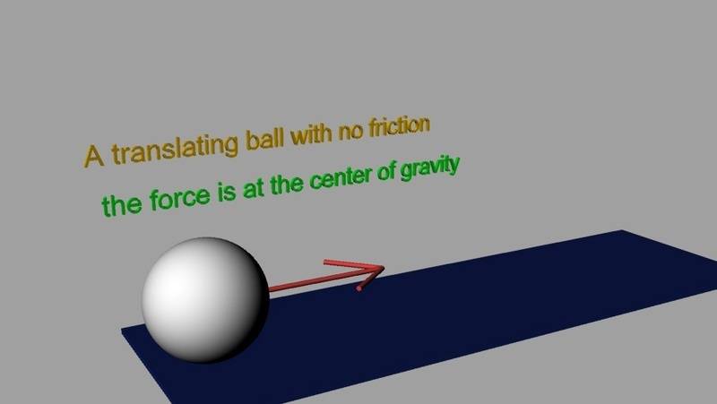

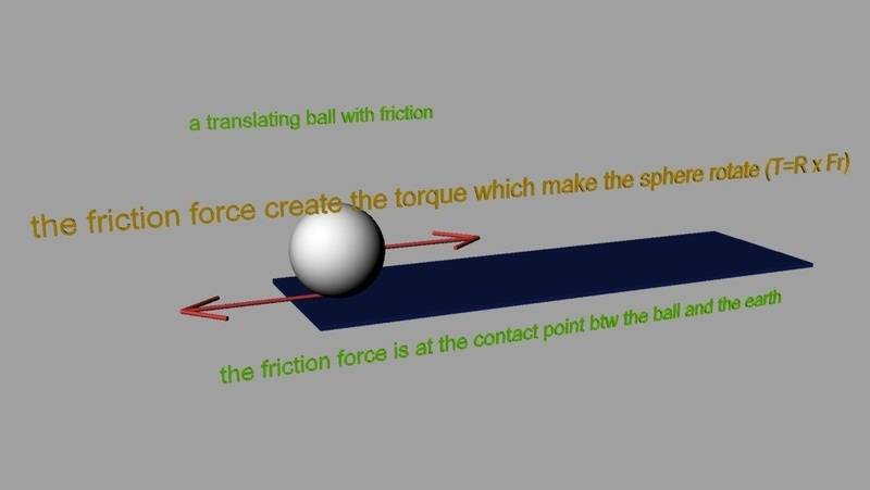

these 2 attached figures , explain the phenomena , I hope it may help , ( friction force = Mu x normal force ).
Mu is the coefficient of friction and it is dependent on the floor type and its roughness.
