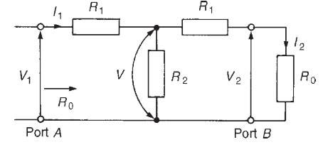

Calculate the insertion loss for the network in the diagram?
20log(N)dB
N = R0 + R1 / R0 - R1
N = 141.42 + 100 / 141.42 - 100
N = 241.42 / 41.42
N = 5.82858
20log(5.82858) = 15.311
Insertion Loss = 15.31 dB
Can someone please confirm I am correct or incorrect?

N = (R0 + R1) / (R0 - R1)
N = (141.42 + 100) / (141.42 - 100)
N = 241.42 / 41.42
N = 5.82858
Looks good. You might use some parentheses to make the order of operations on your math clear :wink:
You probably should have explained where the R0 value came from, although it can be derived from the filter circuit itself with the assumption that it is impedance matched to the source and sink impedances.
R[itex]_0{}[/itex]=[itex]\sqrt{R^2{}_1{}+2R_{1}R_{2}}[/itex]
I suppose by 'N' you mean I1/I2
