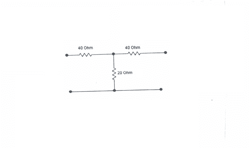

Calculate the characteristic impedance ( Z0) of the two port network shown below:
Could you help me with this question please.
agata78, the Relevant Equations and Attempt at a Solution sections are not optional. If you want help, you'll have to show your attempt first so we'll know how to help you. We can't do your homework for you!
Calculate the characteristic impedance (Z0) of the two port network shown below:
In this example :
R1 = 40 ohm
R2 = 40 ohm
R3 = 20 ohm
V1 = I1 (R1+R2)
Then, Z11 = V1/I1 = R1+R3 = 40+20 = 60 ohm
V2 = V1 (R3 / R1+R3) = I1 (R3+ R1) (R3 / (R1+R3)) = I1 R3
Then, Z21 = V2 / I1 = R3 = 20 ohm
Am I correct so far?

Sure. Note that you can drive a port with a current source rather than a voltage source. This might make some of your work easier, not having to fiddle about with voltage dividers and determining the input current separately.
For example, for Z21 if you drive I1 into the first port then the output voltage on the second port is clearly V2 = I1*20Ω, yielding V2/I1 = 20Ω.
I found the way to calculate T network, where Zor is a characteristic impedance
Zoc= R1 + R2 = 40 + 20 = 60Ω
Zso = (R1 * R2 ) /( R1 + R2 ) + R1
Zso= (40 + 20) / (40+ 20 ) + 40
Zso= 800/ 60 + 40 = 13.333+ 40 = 53.333Ω
Zor= √ Zoc Zsc = √60 + 53.333= √ 113.333 = 10.645 Ω
I hope I am on right path this time
The part in red is incorrect. You have Zor = sqrt(Zoc) + Zsc
It should be Zor = sqrt(Zoc * Zsc) = sqrt(60 * 53.333) = sqrt(3200) = 56.57
Zoc = R1 + R2 = 40 + 20 = 60Ω
Zso = (40 + 20) / (40+ 20 ) + 40
Zso = 800/ 60 + 40 = 13.333+ 40 = 53.333ΩZor = √ Zoc Zsc = √60 x 53.333 = √ 3200 = 56.568
Characteristic Impedance = 56.57 Ω
Thanks for your help! Can you please let me know that this is the correct answer for the Characteristic Impedance or is there further calculations?
This is correct.
