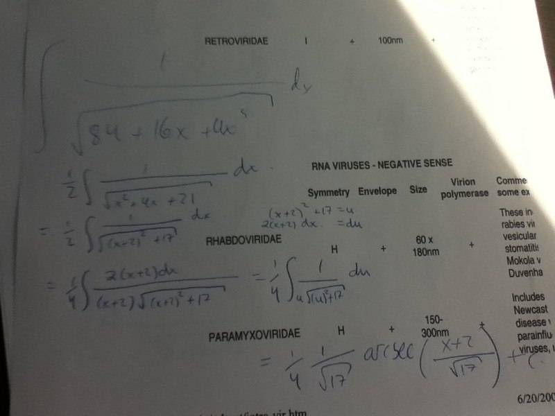

Could you please check this integration?
I get a different answer from WolframAlpha.
Integral of 1/(sqroot(84+16x+4x^2)) dx
Look at picture please! I apologize for the other physiology information. I have no more clean scrap paper left.

So far as [tex] \int \frac 1{\sqrt{84 + 16x + 4x^2}}\,dx = \frac14 \int \frac{2(x+2)}{(x + 2)\sqrt{(x+ 2)^2 + 17}}\,dx[/tex] I agree with your calculations. You now appear to substitute [itex]u = (x + 2)^2 + 17[/itex], with [itex]du = 2(x + 2)\,dx[/itex], from which you should obtain [tex] \frac14 \int \frac{2(x+2)}{(x + 2)\sqrt{(x+ 2)^2 + 17}}\,dx = \frac14 \int \frac{1}{(x + 2)\sqrt{u}}\,du = \frac14 \int \frac{1}{\sqrt{u - 17}\sqrt{u}}\,du[/tex] rather than [tex]\frac14 \int \frac{1}{u\sqrt{u^2 + 17}}\,du[/tex] which is what you have.
It would have been better to substitute [itex]x + 2 = \sqrt{17} \sinh \theta[/itex] after completing the square in the denominator. The motivation for this is that [itex]\cosh^2 \theta = 1 + \sinh^2 \theta[/itex] and the derivative of [itex]\sinh \theta[/itex] is [itex]\cosh \theta[/itex]. You therefore end up with a constant integrand.
The issue here is when you do the u substitution and plug in your values for u. You should have written
##\frac{1}{4}\displaystyle\int\frac{1}{\sqrt{u-17}\sqrt{u}}du##
I wouldn't do u-substitution for this problem. Try doing trig substitution: ##x+2=\sqrt{17}\tan{\theta}##

The step after you complete the square in the denominator. If you haven't learned hyberbolic trig functions, then use my suggestion. I have a feeling pasmith's substitution is a bit cleaner but there is nothing incorrect about using tangent.

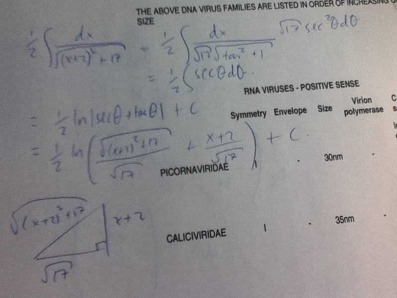

Dear Sirs/Madams,
Here is my second attempt. But, I graphed it and it does not give the same answer as the hyperbolic function that wolfram alpha gives me.

That looks good to me. What did Wolfram give as an answer? Likely, you could manipulate that answer into the answer you gave.
ArcSinh[(2 + x)/Sqrt[17]]/2
The functions do not match!
They are equivalent to each other. Plug their difference into WolframAlpha to see:
ArcSinh[(2 + x)/Sqrt[17]]/2 - 1/2log(sqrt{(x+2)^2+17}/sqrt(17)+(x+2)/sqrt(17))
A good exercise for you would be to use the definition of arcsinh to write that form into your form.
As a starting point: ##\sinh^{-1}{x}=\ln{(x+\sqrt{1+x^2})}##
