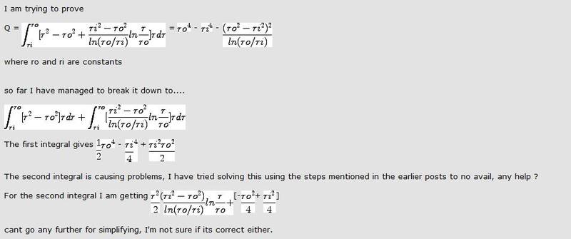

thanks for your help. this was a simplification of a Navier Stokes equation but I am having problem simplifying the equation after integration...
original Integral
Q = [tex]\int^{ro}_{ri} [r^{2} - ro^{2} + \frac{ri^{2} - ro^{2}}{ln(ro/ri)}ln\frac{r}{ro}]rdr[/tex]
where ro and ri are constants
so far I have managed to break it down to...
[tex]\int^{ro}_{ri}[r^{2} - ro^{2}]rdr + \int^{ro}_{ri}[\frac{ri^{2} - ro^{2}}{ln(ro/ri)}ln\frac{r}{ro}]rdr[/tex]
The first integral is straight foward but the second integral is a bit confusing
can the second integral be written as
arln(r/b) and solved ? where a and b are constants and then substitute the ri,ro for a and b after integration
