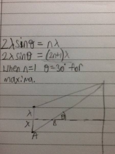

Is this correct ?
I have an issue for the minima formula when n=1 I get theta = 90 degrees.
This doesn't make any sense.
Is my method correct ?

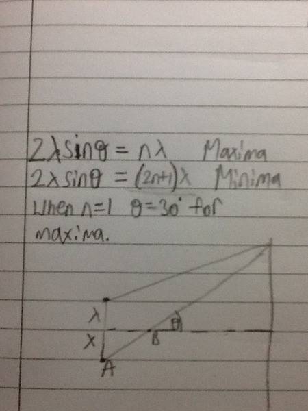

Your general method is correct, but your formula for the minima is incorrect. Check your notes or text.

Okay, for minima : 2λsinθ = mλ m=0.5,1.5,2.5,3.5...
This would give me the required non-integr half wavelengths for a minima, correct ?
EDIT : Hence m =0.5 would mean the first minima is at 30 degrees.
maxima : 2λsinθ = nλ n = 0,1,2,3,4,5...
For n =1 I still get theta to be 90 degrees... I don't see what I'm doing wrong.

No. 2sin(theta) = 0.5 does not yield theta = 30 deg.
No. 2sin(theta) = 1 does not yield theta = 90 deg.
Ah, God, silly mistakes... Forgive my lapse in concentration. Its pretty late where I am right now.
I've understood this question now. Thank you.
