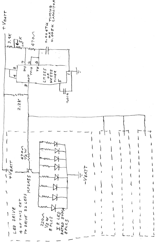

I've seen the designs using the 555 timer as the base and making a 2 led IR emitter. These examples use 5v and only two leds to send the 40k signal. http://www.reconnsworld.com/ir_ultrasonic_555timer40khzir.html
I would like to modify this design to run off 12v and use 8 infrared leds. I building a lap counter, I searched the forums and haven't found anything helpful yet. My idea was to build a bridge across the track and have leds space 1.5 inches across pointing down at the track surface, the bridge may be up to 20 foot wide, I am building it in removable 4 foot sections. My idea was to put the counters on the cars themselves and use one common transmitter (aka the bridge) to send one siginal, IR at 40khz. Each car will carry their own receiver to capture and record the beacon when it goes under the "bridge." I built a very rough counter and have sucessfully tested using a remote control. I need to filter out the daylight some more but the counter part works, if I could just get my transmitter together the way I want. My plan is to be able to hook the transmitter bridge up to a car battery (12volt) and the way I have it design, I will be able to add or remove sections of 4 foot intervals to my bridge for changing track shapes, locations (we race in parking lots). I figured I would have up to possibly 160 leds over 20 feet. Using 32 leds in every 4 feet, 8 leds in every foot, I'll have a 40khz emitter board/circuit every foot. These will be connected parallel to the main 12volt supply.
Now, these are not slot cars, so break beam systems will not work because at any given moment, a car could pass the counter at any given 20 foot section of asphalt. To keep from broadcasting 6 or 7 different signals from the cars, there will be more than one racing at the same time, I decided to have a common transmitter, the bridge, at 40khz, shooting down at the track, and each car will carry its own onboard lap counter and IR receiver.

Here is one approach that may be useful. It uses a single 555 timer and four transistors to drive 32 LEDs at 40mA to 60mA each, over a supply range of 10.5V to 14.4V.
Notes:
1) Although they may not be needed, have capability on the connections between 4Ft. sections to carry 2 signal leads. It may turn out that you need to synchronize the LEDs so they all flash at the same time. It depends a lot on the optics and on the receivers on the cars.
2) The timing resistor, R3, has a 3.9K resistor in series with it to put the adjustment about in the middle of its range for 40kHz operation.
3) For timing stability over temperature, the timing capacitor, C1, should NOT be a ceramic capacitor.
4) The timing capacitor, C1, in the original ckt. is 0.0047uF. This is now a non-standard value and may be hard to find. A value of 0.005uF is a reasonable replacement.
5) As you noted, at maximum bridge length there are 160 LEDs. These could fire all at the same time resulting in an 8 Amp peak current. Use decent connectors for the wiring.
6) When designing the assembly, think about doing repairs in the field while being under pressure for the next race. You want to be be able to quickly change faulty boards, or LEDs, with a spare. Use connectors on the boards and decide how you will replace LEDs.
*** As with any high-capacity battery supply, have fuses or circuit breakers in the power leads. ***
If you uses fuses, have plenty of spares; they don't like pulsed loads and are subject to early failure.
This can isolate any problems that occur without potentially frying all the pieces. (but I suppose you could bill it as extra entertainment for the spectators!)
