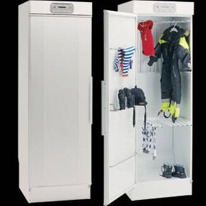

Swedes are never satisfied. :wink: When I lived there, the only type available was the torkskåp. It was terrible.
