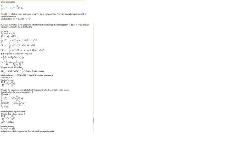

Most of the book using PV=nRT for PV^gamma constant for adiabatic process.
However, please refer attachment, proving using conservation of energy will also make sense?

The derivation in your attachment seems to start half way through. Where does your first line come from?
The derivation
Please refer attachment it seem using this method, it able to change instaneneous equation to continuois equation.
Equation A
5/2P1V1-P2(dv)=5/2(P2)(V1+(dv))
will be transform to
Equation B
10.4/V1=P1+2/5P2
However the "V1" in equation B will represent the value of "V1+dv" in equation A and dv is eliminated both equation A and B showing same charateristic.

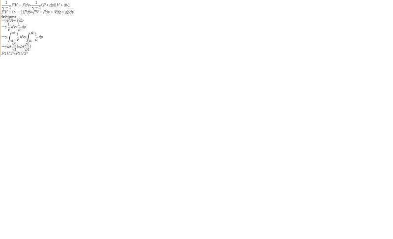

I consider adiabatic derivation using conservation of energy and the same way as above
Intial internal energy of gas-work done by gas=Final energy of gas
the P2 dv is change to Pdv since the pressure being compress of expand is the instataneous gas pressure in cylinder
1/(γ-1)PV-P(dv)=5/2P2(V+(dv))
However, dv can be +dv or -dv depend the volume expand or compress
After tranform it will ge PV^γ

For the derivation of pv gamma using PV=nRT, i do know how to get it. However, i would like to try other concept to get it as well.
Sorry for my poor explanation.
At the moment, I would like to understand the below question to know whether i on the right track.
A)the internal energy of gas in a cylinder with volume V and pressure P can be written as
1/(γ-1)PV correct?
B)when compress the gas by a small volume dv, the work done on gas is P*dv?
C)The final internal energy is the sum of work done (P*dv)+initial internal energy(1/(γ-1)PV) correct?
1/(γ-1)PV correct?
Correct for an ideal gas. This is just algebra ie:
The internal energy of an ideal gas is:
U = nCvT = n(Cp-R)T = nR(Cp/R-1)T = nR(Cp/Cv)(Cv/R)- 1)T = nR(γ(Cv/(Cp-Cv)-1)T= nR(γ(1/(γ-1))-1)T = 1/(γ-1)nRT
Since PV = nRT, U = 1/(γ-1)PV
Not quite. The work done ON the gas is -PdV. The work done BY the gas is PdV.
Not quite. PdV is the work done BY the gas. The final internal energy is the sum of the work done ON the gas (-PdV) and the initial internal energy.
So:
U = Ui + ΔU = Ui + W = Ui - ∫PdVAM

I am trying by means of calculus can the equation as below
5/2P1V1+Pdv=5/2P2V2
or
5/2P1V1-Pdv=5/2P2V2
integrated become P1V1^γ
chuakoktong said:
Dear Mason,
Thank for your fast reply.
The reason i advoid using calculus is because i trying to break down thing part by part for my further understanding.
I been thinking as far as things are interrelated, maybe same result/answer can also be obtained by using different way(i.e taking different path leading the same destination)
5/2P1V1+Pdv=5/2P2V2
or
5/2P1V1-Pdv=5/2P2V2
But P2 = P1+dP and V2 = V1+dV. So:
your equation becomes:
(1/(γ-1))P1V1 - P1dV = (1/(γ-1))(P1+dP)(V1+dV) which is equivalent to:
P1dV = -(1/(γ-1))(P1dV + V1dP)
And all that says is that W = -ΔU (ie. it is adiabatic).
