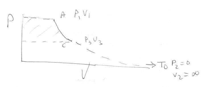

How did you arrive at w = 0 for the second expansion?
Don't forget that full expansion into a vacuum implies that P2 = 0 & V2 = ∞
The work done is pv work which is the area in the pv indicator diagram shown.
Between some point C at P3, V3 (say 1 atmosphere) and vacuum (unattainable) the work is shown by the hatched diagram.
If you take it all the way to infinity as shown the work is the area under the whole graph.
You need to integrate an equation of state for the gas to obtain this figure.
  • Hand-drawn P-V indicator diagram with P on the vertical axis and V on the horizontal axis; point A at P1, V1 at top left, a hatched area under a curve from A down to point C at P3, V3, then a dashed curve continuing to the right toward T0, P2 = 0, V2 = infinity.
