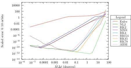

we've a basic numerical integration assignment, using simpsons/trapezium rule to calculate some non analytical function.
Logic suggests that you use as many "strips" as possible (ie. as small a value of dx as possible) to estimate the value of the integral, however I've seen some graph some time ago showing how error can actually start to increase with smaller dx's, because of floating point rounding, and the inherent error of the methods. anyone seen/got anything like this (for a 32bit computer??)

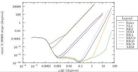

Using finite arithmetic, making the step size too small does indeed lead to loss of accuracy. The attached plots show how step size affects integration accuracy for a variety of integrators. The problems investigated are a torque-free symmetric top and a circular orbit in a spherically symmetric gravity field.
Yep, its a well known fact of life.
Often higher order methods are a good workround, as DH's graphs illustrate.
Another good rule of thumb is: never do ANY "serious" computing in 32-bit precision.
