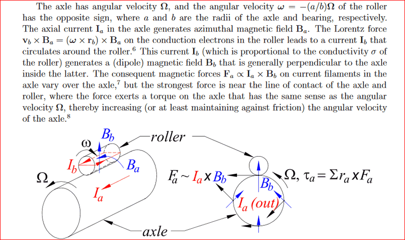

Did you check that electromagnetic explanation for Latheman's ball bearing motor ?
http://www.physics.princeton.edu/~mcdonald/examples/motor.pdf
Bearing currents (called shaft currents in my day) were attributed to imperfect, slightly asymmetric flux distribution in the machine resulting in some flux linking the shaft causing current to circulate longways through the rotor and frame via the bearings. I noticed it on the 400 kva generators that fed our control rod drive system.
