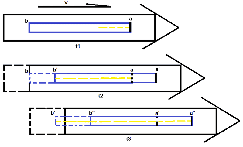

Is this analysis right
A spaceship is traveling at a steady speed V in the direction shown. Inside the spaceship is a simple clock of length L and consisting of a light source at “a” and a mirror at “b”. The light leaves “a”, bounces off the mirror at “b” and goes back to “a”, which counts as a single tick of the clock.
As the spaceship is moving the clock is shown at times t1, t2, and t3. At time t2 the clock which was originally at a and b will now be at a' and b'. Time t2 is the time the light reaches the mirror.
The mathematical analysis for the time taken for one tick to occur is
T = ((L – vt)/c) + ((L + vt)/c)
(L – vt)/c = is the time taken for the light to leave the light source and travel to the mirror.
(L + vt)/c = the time to do the return trip.
vt = the distance traveled by the clock in the time it takes for the light to travel the length of the clock.
do I have to allow for length contraction? Is the above correct?

It looks right. Is this the time measured by an observer watching the spaceship go by or is it the time measured by an observer inside the spaceship. Does it matter?
it is the time measured by both and the same would be observed by both. If that is the case it appears the observer inside the spaceship would observe the clock, and thus the spaceships, movement relative to the photons in the clock!
Ross B said:
... would observe the clock, and thus the spaceships, movement relative to the photons in the clock!
Remember that the speed of light is c regardless of the frame of reference.
You asked if you have to allow for the length contraction of the spaceship as seen by an observer who watches it go by. Obviously, from the viewpoint of that observer the spaceship is shorter by a factor of γ. If the spaceship is shorter and the speed of light is c, why does light take the same amount of time for the round trip in the two frames? I think the answer to that question is the lesson to be learned in this problem.

so just to clarify my analysis is right?. The person inside the spaceship would use the same analysis?
and length contraction is only observed by and observer moving relative to the space ship
No. The person inside the spaceship does not see the mirror move. Therefore, the time for the round trip is T = 2L/c however the "go" trip takes the same amount of time L/c as the "return" trip. That is is not true for the person on the ground. Although the time for the round trip is the same, the "go" trip takes less time than the "return" trip as you have calculated.
