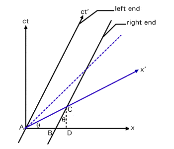

Yes, A is measuring length contraction of B. And the catch is in relativity of simultaneity i.e. in A's "now" he is longer than B while in B's "now" he is shorter than B. This is best seen in spacetime diagrams. For example like this one:
Now compare length of AC (in "now" of moving object) and AB (in "now" of stationary observer).
